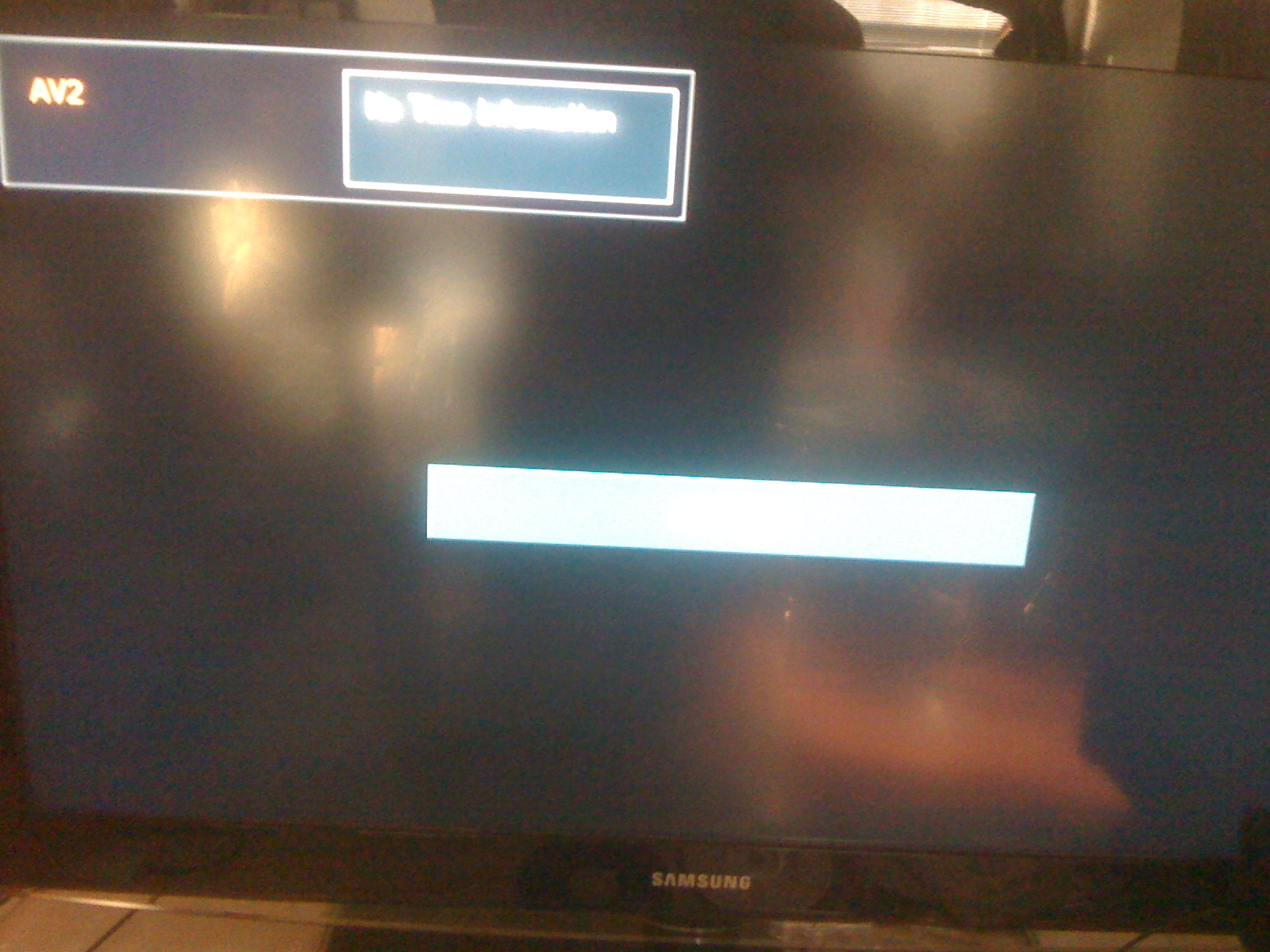

    i've created a video of what's happening now.
    i'll take you through the video...
    i put the tape in. hit play. static appears for a split second and then the screen changes to a blank screen. now this blank screen is what i see when i usually don't have my video cable plugged into my tv. it's the AV mode.
    and that's what it's showing me. i tried it twice. and each time with the same result.
    last night it was showing me static. now it won't even play.
    just this.

    5.now it won't even play. i have attached a video. please watch it.

    I saw the video, and it does not seem to me like the tape is playing.
    Stop fooling around with the tape. It won't play using the equipment you have. It is 27 years old, and you are not doing it any favors by attempting to play it back on the wrong equipment.

    I'm not fooling around with it!
    I was just trying to demonstrate what exactly was the problem. because it was playing yesterday. and today it's doing this. so i didn't know why.
