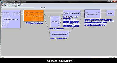

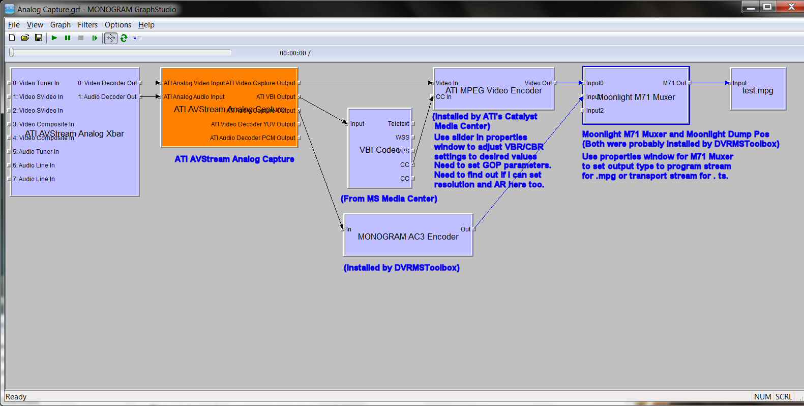

    If you want to try edDV's suggestion of using a filter graph for capture to utilize your card's hardware MPEG-2 encoder, this is a screen capture of a filter graph I made some time ago using GraphStudio for the TV Wonder 650 PCI-e. ATI's filters can be found under Graph->Insert Filter in the WDM Streaming Capture section in the drop-down filters list. I think the Dump filter used is Moonlight DumpPOS which I think was installed along with with DVRMSToolbox. Just drag and drop the pins as shown and right-click on the filters to configure their settings
    I hope this proves useful. Unfortunately, my TV Wonder 650 PCI-e died a few weeks ago, and I have uninstalled the card and its drivers, so I can't load the real graph I saved to check anything for you.

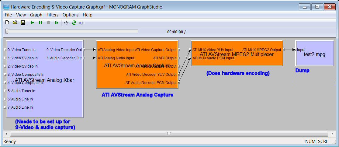

    Aug 2006

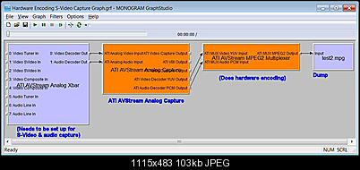

    I don't remember whether ATI's software encoder offered a higher bit rate than the hardware encoder or not. I think the software encoder filter came with Calalyst Media Center. Here's another capture graph employing the software encoder if you want to take look. Encoding closed captions is optional.
Name:	Diamond 650 S-Video Capture Graph.jpg

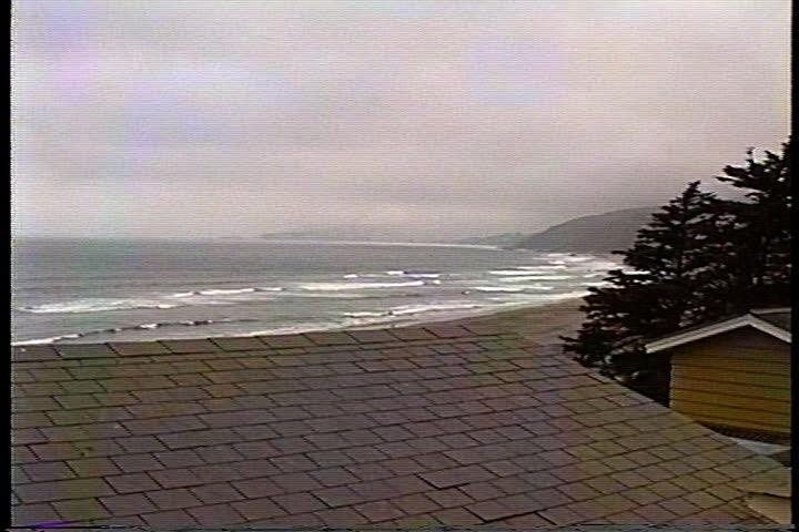

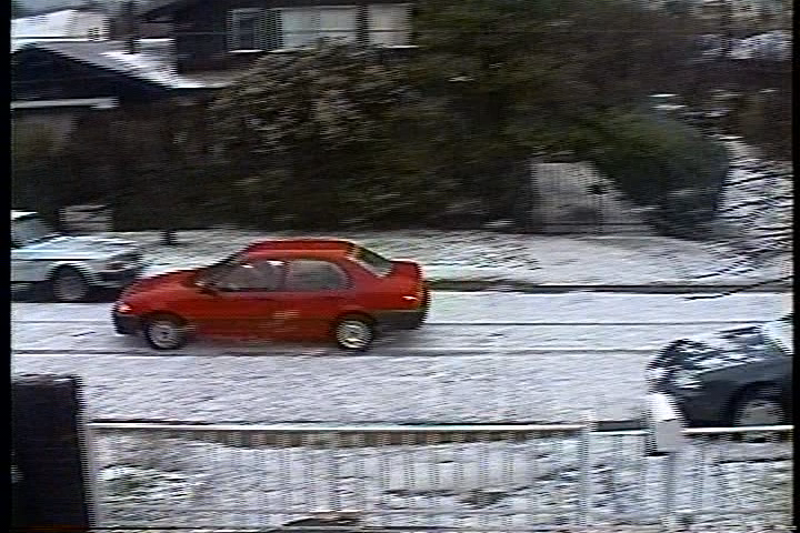

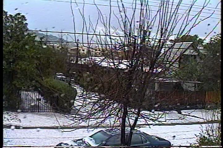

  22. Here are the captures...
    What do you think? (THE ONES WITH "NO AUDIO" ICON ARE HC025, the other ATI encoder...

  27. OK, here they are... what do you think?
    Is it worth it to go with HCENC or I keep using ATi encoder which is the fastest for me?
  28. I see several differences:
    1) The HcEnc encodes are sharper. But since I don't know what the videos looked like before encoding I don't know if the ATI encoder is blurring the image or HcEnc is sharpening. I think it's the former. But VHS caps are often over sharpened by the VHS player (because VHS has inherently low resolution) so a little softening may be called for.
    2) There's a color problem with on of the encodings. Or maybe just the way you produced the screen caps. Notice how the red car and the red door are different shades of red. This is probably because one of them is using rec.709 color, the other rec.601. Without seeing the video before compression, and both compressed videos, I can't tell you which is correct. But standard definition video should be coming out of the ATI 650 with rec.601 color. And the MPEG 2 file should also be rec.601. DgIndex will tell you if the MPEG video is flagged as rec.601 or rec.709.
    3) With so much macroblocking it's hard to say which video has more. Especially since one is producing less sharp video. The frame type (I, B, P) may also differ (B frames are encoded at lower quality settings and will show more macroblocking).
    See if you can sort out the color problem, then go with whichever you prefer. Be sure to watch them on TV at normal playback speeds as well as looking at still frames.
  29. Thanks for your answer.
    Here I upload one image of the red car which is lossless lagarith. I also uploaded other two images in lossless lagarith codec.
    The ATi encoder seems to be the correct red...
    Also that the HCenc is sharpening.
    I'am trying AVStoDVD which seems to be in the middle of both encoders. Good quality and easy of use... Taking longer times thou.
  30. Originally Posted by Marto2008 View Post
    Note that you can specify the colorimetry in HcEnc (on the Settings 2 tab of HcGUI). Use BT.470-2M or BG.
    That's odd because I've never really noticed it in my own encodings (I don't do much MPEG 2 encoding anymore though, and when I was doing lots of it I was using CCE). Check which Matrix you used.
