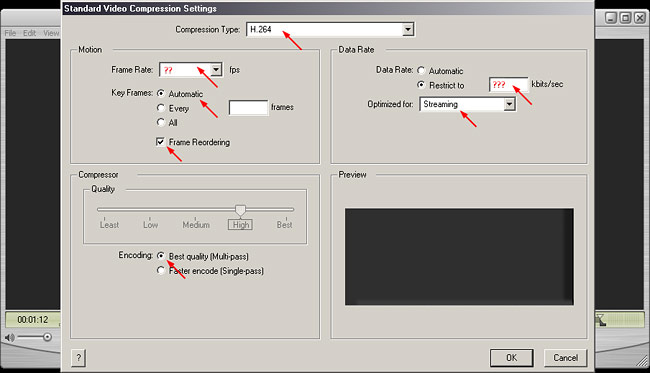

    Adjust the bitrate for lower file size.
    In quicktime I think can you adjust the h264 quality settings or set the data rate/bitrate directly for lower file size.
    Does it look like this?

    H264 is fine if you are creating a DATA DVD in order to store the compressed file....but that file is NOT going to play on a plain old DVD player attached to your television. DVD is MPEG2 and only MPEG2 and needs to be authored as a DVD. Simply burning files to a DVD doesn't make it a "DVD".
