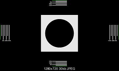

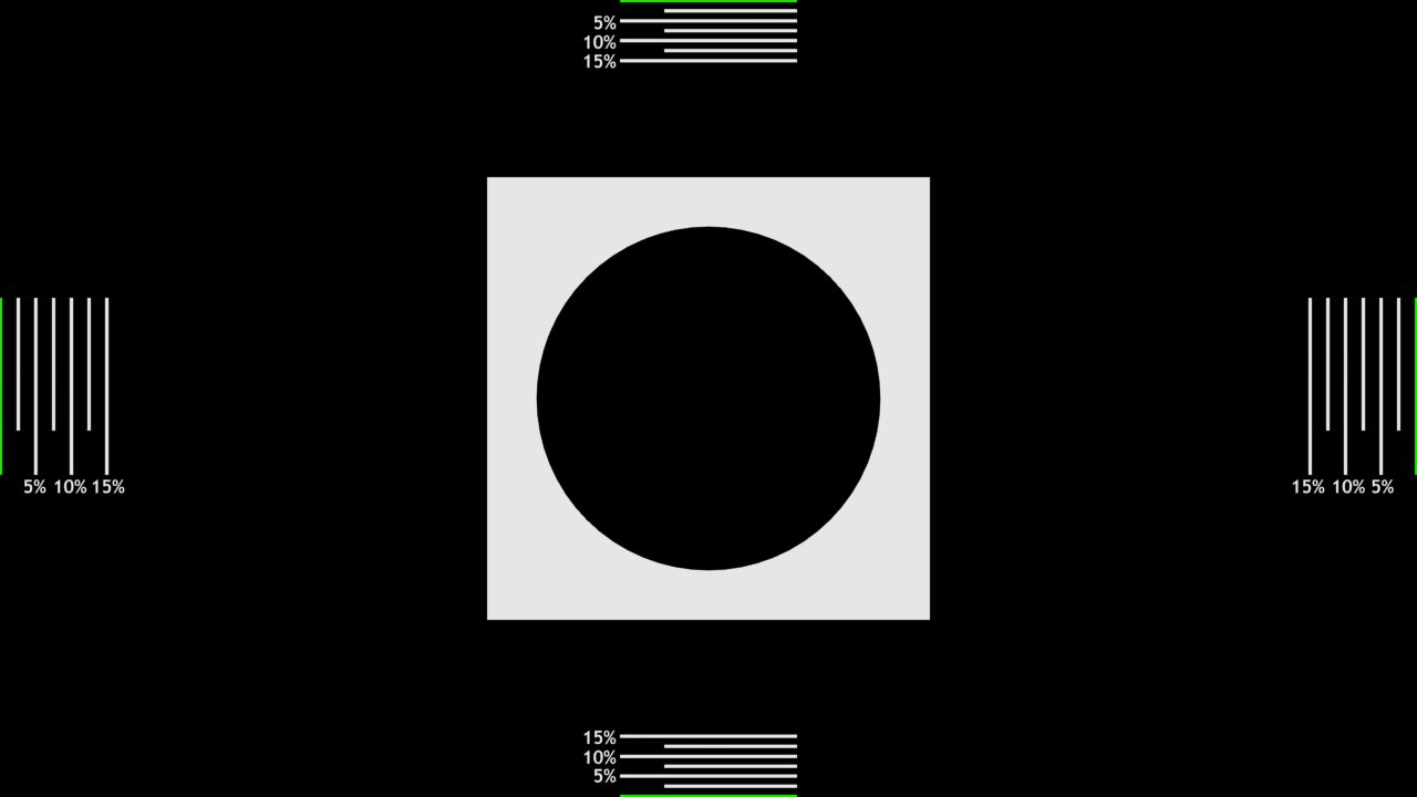

    The proportions of the video look OK to me - I normally notice when it's off. You could confirm by holding up a dinner plate to the cam and checking the dimensions.
    It's possible the resolution your computer is set to doesn't match your display's dimensions.
    Click on the image to enlarge, and measure the width/height of the square with a rule:
