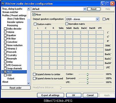

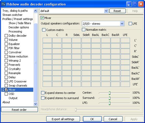

    Mar 2008
    I already mentioned a method in post #6.
    The act of passing the audio through FFDshow's mixer does the magic for you.
    Just remember to set the mixer to stereo:
