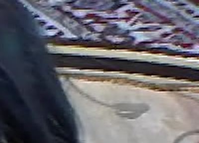

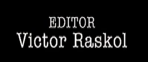

    I'm trying to convert a dvd with really poor image quality.
    It's an NTSC dvd with progressive frames (dixit gspot and megui detection tool), but there actually seems to be some kind of interlacing left.
    I'm quite puzzled as to what to do. I tried some antialiasing scripts (after I read the thread about Jagged Edge Of Video Picture), but I feel like a chimp in a cockpit. I do realize I need to get into avisynth instead of relying solely on Megui, and I'm starting to learn the basics.
    Here's a detail of the credits (200%):
    And here's a detail during the movie (200%):

  2. It does seem to be from an interlaced source that was encoded as progressive. But a better sample would be one you cut from the main movie rather than from the end credits, one with steady motion. Can you upload another sample?
    The credits improve tremendously with a simple deinterlacer, even Yadif, although there are other better ones. You don't need to antialias it, but to deinterlace it. Unless you're keeping it as a DVD.
  3. ^just to add to manono's comments : often credits have completely different characteristics than the main movie. Sometimes they are processed in a different facility than the main movie
    and I see you zoomed in the editor's name (suspected culprit ? ... to be fair it might not be his fault. There can be multiple points where something goes wrong in the workflow
  4. It seems to me, that the odd fields are botched, but even fields are largely intact
    maybe qtgmc(inputtype=1) on the odd fields? or even just keep the even fields with the deinterlace and drop the odd

    I hope this 3-second sample (kind of sfw) will be ok. I cannot find any longer sfw scene, and it displays the annoying effect on the top of the couch:
    http://www.mediafire.com/?3w4d6vib8wa4my6
    I already tried to deinterlace with yadif and all the others deinterlacers available in megui, it does help a bit, but it stays very noticeable in some scenes.

  6. It works ok on the credits, except for the 1st and last few frames (because of the way temporal filters work), I trimmed them off in this example.
    I'll have a look at the other section in a bit
    Mpeg2Source()
    AssumeTff()
    SeparateFields()
    f1=SelectEven().qtgmc(inputtype=1, preset="slower", sharpness=0.6)
    f2=SelectOdd()
    Interleave(f1,f2)
    AssumeFieldBased()
    Weave()
