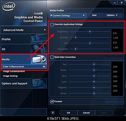

    It's just the brightness, contrast, saturation, and hue controls in the "video" section of your graphics card setup applet (Control Panel -> Display...). Here's one from the computer I'm on now:

    Different drivers will have a different interface. Just be aware there are two areas where you can adjust these settings. One is for everything on the Desktop. You don't want to use that one. The other is specifically for video playing in a media player. You want to adjust that one.

    All you have to do is play the video in VLC then adjust the brightness and contrast settings until the video looks like first image in that post.

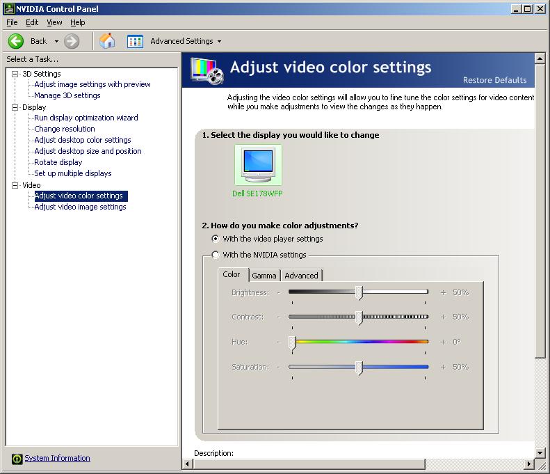

    Below is a screenshot of the NVidia Control Panel. Is that where I play with settings?
    Mine is an ex-Vista computer running XP (I set it up from scratch), so I know for sure that it makes my monitor "tick".
    [Attachment 9464 - Click to enlarge]

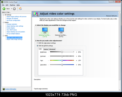

  10. I can't see your image, even if I click on the link. But here is where you adjust the video settings on the Nvideo control panel:
