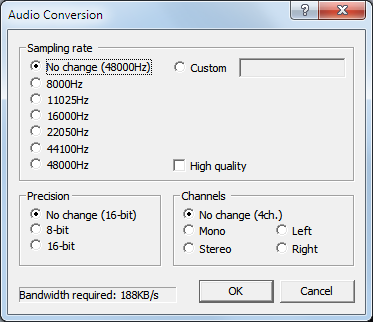

    Audio -> Conversion... convert to something that's compatible with your MP3 encoder. For example, 48 KHz, 16 bit, stereo, high quality.

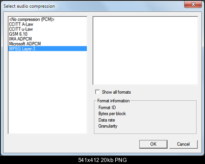

    Here's a video with 4 channel audio:

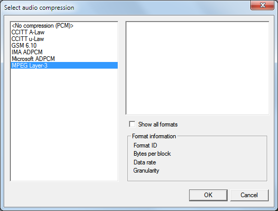

    The mp3 encoder doesn't support 4 channel audio so it shows no options:

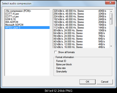

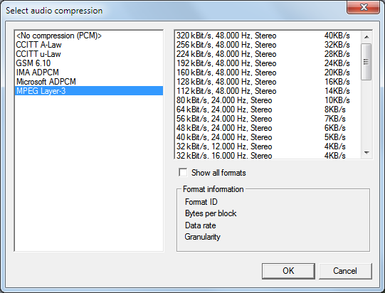

    After converting the audio to stereo you can see supported options:

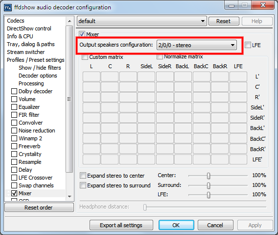

  7. I'm talking about the system installed ACM AC3 decoder. It will have a a downmix option. I don't have one installed right now but here's an example from ffdshow's AC3 decoder:
