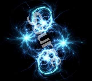

  8. The animation is slow moving cgi - geometric patterns and the like. Lots of very bright and vivid colours:

    The DVD will be burnt onto a DVD-R - but that is being done at a distribution plant, which specialises in DVD duplication as opposed to replication.

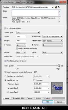

    A "progressive" NTSC DVD needs to be 23.976+pulldown flag.
    In Vegas you would spec progressive (no fields), and 23.976 under DVD Architect "24p" MPeg2 templates.

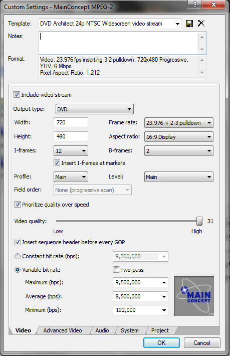

    edDV; I've been using the wrong template. That one you show looks to do exactly what I am after. So, if I understand this correctly - Vegas will ecode the NTSC MPEG as progressive (no field order), and then the DVD Player will use the pulldown flags in order to interlace the video if necessary?

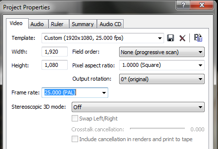

    Originally Posted by jnms View Post
    Also - one other question (sorry) - as the source material is still images...what field order should I use on the encode? (At the moment I have selected 'Progressive (NONE)' in Vegas. Will this result in jitter?

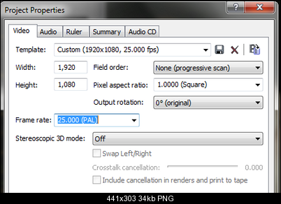

    Set project to 1920x1080 25p

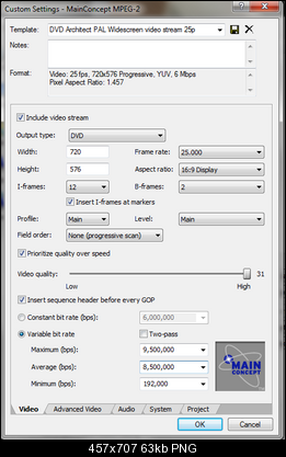

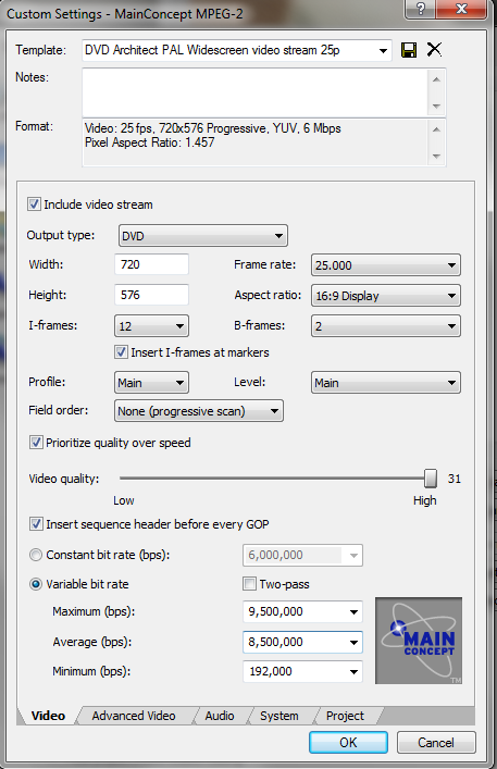

    For a PAL DVD render you have two choices.
    1. Render interlace -- use "DVD Architect PAL Widescreen video stream" template. It defaults to interlace lower field first. You can change that to upper field first optional.
    2. Render progressive -- start with template above and change to None (progressive)
    I'd render both ways and test in various DVD, Blu-Ray and computer players.

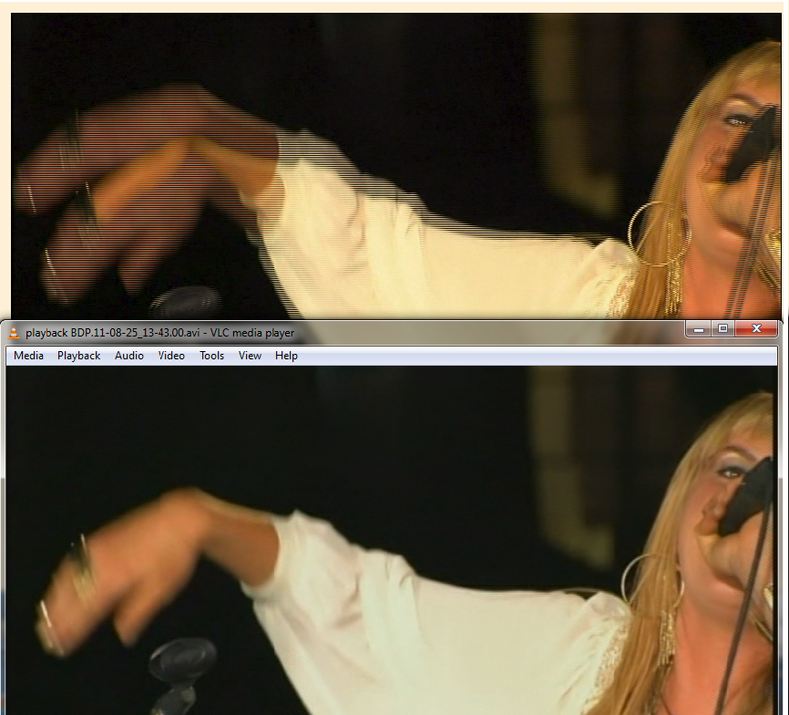

  27. Member edDV's Avatar
    Mar 2004
    Northern California, USA

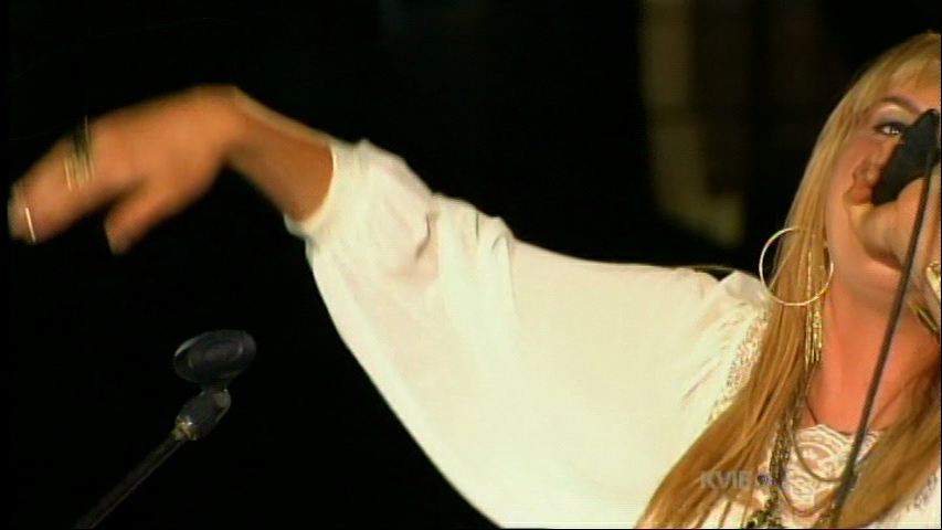

    I'll copy the test here:
    Source was a PBS 1280x720/60p MPeg2 broadcast captured direct as mts.
    I decoded the MPeg2 to Sony YUV 4:2:2 codec (720 60p uncompressed project).
    Then I exported a clip to 480i DVD at 9500 kbps CBR ("render as" 720x480, 29.97, upper field first)
    The upper picture is a frame capture of the 720x480i render. After 60p->60i conversion, both fields are distinct as they should be.
    I then played the 480i file in my Sony BVP player and stepped through frame by frame at 60p (post deinterlace) and could see all fields converted back to frames. The lower picture was recorded off the BVP composite output as a sample of the deinterlace.
    [Attachment 8347 - Click to enlarge]
    click on picture to see full size
    What this shows is Vegas Pro 10e can properly convert 60p to DVD 480 60i. It also shows a good progressive DVD/Blu-Ray player or HDTV can convert the resulting 480 60i back to 60p.
    PS: Here is the other field from the Blu-Ray player.
    [Attachment 8348 - Click to enlarge]
    Too bad VLC has screwed up the chroma channels in the interlaced shot! It's interpreting interlaced chroma as progressive chroma. But that's a VLC problem, not a problem with the encoding.
  30. Member edDV's Avatar
    Mar 2004
    Chroma wasn't controlled for this test. The point was progressive to interlace back to progressive worked.
    In the process, chroma was converted several times.
    ATSC 4:2:0 decoded to 4:2:2
    then encoded back to 4:2:0 DVD MPeg2
    Then the Blu-Ray player out was composite NTSC just for capture convenience.
