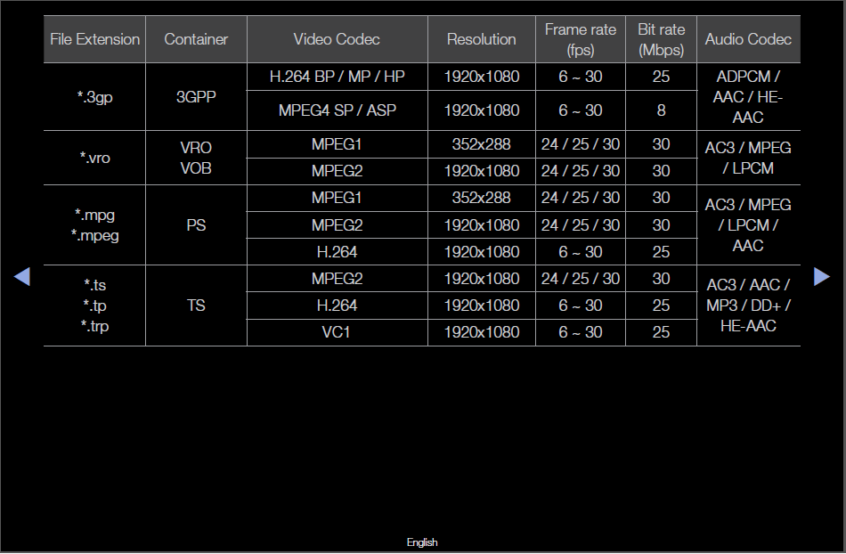

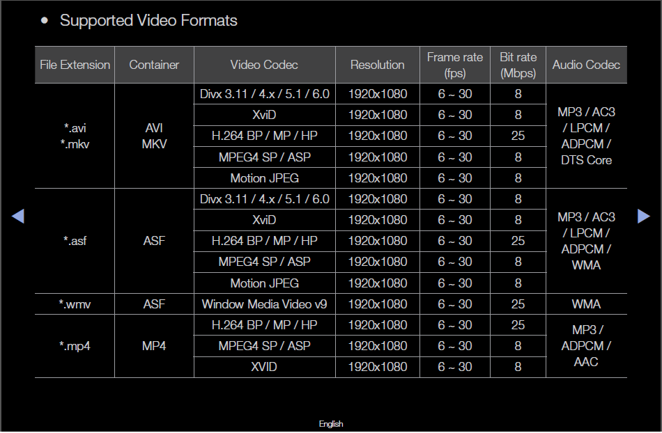

    I have attached three images strait from the Samsung manual stating the supported codec's.
    I am using Xilisoft Video Converted Ultimate 6 and have tried everything under every video menu and converted it. It seems hit or miss.
    I am converting the files and then streaming them over my network to the TV in case you are wondering.
    If it plays the video, there is no audio because it does not support the audio codec. The other times it says un-supported video format which means it does not like the codec I'm assuming.
    The TV is a Samsung UN55D7050 LINK
    Just in case you are wondering I have been attempting the supported codec's listed in the manual and not just shooting from the hip.

  8. I'd ignore any advice regarding sticking to DVD spec, Blu-Ray specs etc. We're no longer living in the dark ages.
    I own a Samsung Plasma (I live in PAL-land) and my supported file types/codec list looks identical to the one you posted (from memory). My TV's media player will play pretty much anything (well all the common video types you'll find in typical containers such as AVI, MP4 and MKV etc). You mightn't be able to play "PAL video" as such (by that I mean 16:9, 720x576 "DVD type video") but I'd be astounded if the player won't play an AVI/MKV/MP4 etc simply because the frame rate is 25fps. Chances are you're not trying to play much of that anyway.
    I play all my video via a hard drive connected to the USB input. Whether it all changes when streaming I have no idea, but before assuming the TV's media player is the problem as such, maybe try putting a problem file on a USB thumb drive and playing it that way.
    Sometimes, for reasons I can't define, the TV refuses to play something it appears it should, but so does my Sony Bluray player. They're never files I encoded myself though. Generally if one won't play something, the other will, so it's not often I bother trying to work out why it's happening anyway.
    Here's we're I'd start. Have a look at the videos you have which won't play using MediaInfo (there's a link to the portable version which contains no adware) that'll tell you what's inside and whether the TV should play them, at least according to the specs. If you switch to HTML view (using MediaInfo) you can post the details here if you're not sure. Likewise you can post the info for the re-encoded versions which won't play. I don't use Xilisoft so I have no idea what it's output might have been or the settings you've used.
    If I'm converting I generally use the x264 encoder for video (I assume Xilisoft can encode using it) with the default settings and High Profile, Level 4.1 in an MKV. My TV has never failed to play one of my encodes. My files usually contain MP3, AAC, AC3 or DTS audio and it has no problem with any of those.
    You might also try opening the original video with MKVMergeGUI (I don't think it supports mov files but it'll open AVIs) and use it to remux the audio and video as MKV (no re-encoding). Sometimes it's not the video or audio which is the problem but the way it's muxed into the file itself. If the player supports the type of audio and video in your AVIs it should play them after they've been remuxed as MKVs with MKVMergeGUI. If it finds a problem it should offer an error or warning when muxing.
    Video To Video Converter has a conversion preset called "direct stream copy". With any luck it'll open your mov files, copy the video and audio and save the output as MKV. Once again you could test the MKV version before heading down the re-encoding path.
