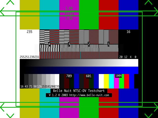

    I don't believe that first statement is true. I just uploaded some NTSC test patterns, resized to 640x480, and to examine, I looked at the downloaded youtube encode, not in the native viewer (which might be resized)
  21. 1 original video
    2 youtube video
    3 bob deinterlaced (if youtube applied a simple field resize this is what it would look like)
    No loss of resolution in #2 when looking at the resolution patches, just the typical compression artifacts
    http://www.youtube.com/watch?v=_MU1KM7Ojus
    Watching the video at 480p on YT (with the player expanded) and the downloaded .flv shows half the vertical resolution.
    Here's the video I uploaded:

    I'm going to guess it's a PAL 25FPS issue, that might incite YT to butcher it
    I re-encoded your source video with 29.97, and it looks fine (look at the 480p version)
    http://www.youtube.com/watch?v=h0FoH4wo8mc
    I'll do some more tests, there might be other factors causing it to deinterlace it
  24. 25fps re-encoded looks fine too....
    http://www.youtube.com/watch?v=jiiy7A9QswA
    Might be an encoding or container issue signalling YT to deinterlace (different mp4 wrapper like mp42 vs isom)
    EDIT:
    Nope, even your original looks fine uploaded on my standard account
    http://www.youtube.com/watch?v=mkY3bGmETI8
    Maybe they don't like you ?
