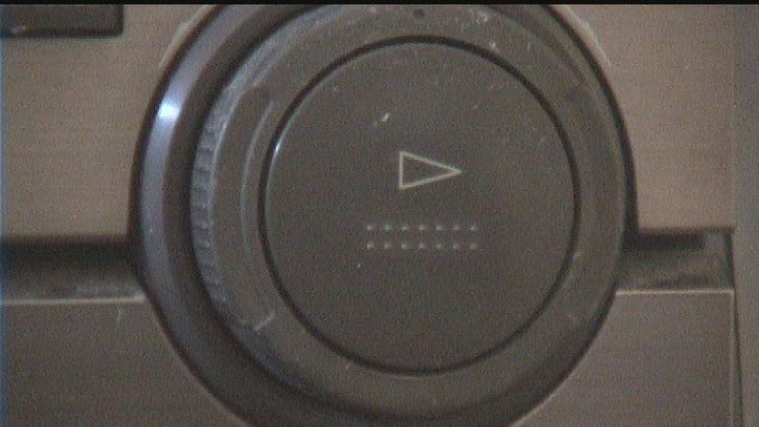

    For example, I can change the aspect ratio flag to wide in Vegas by setting clip aspect ratio to 1.2121 and rendering the file. There is no re-encode if you export to DV. After setting the flag to wide, it will display like this.
