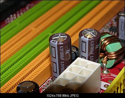

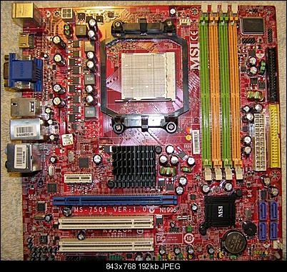

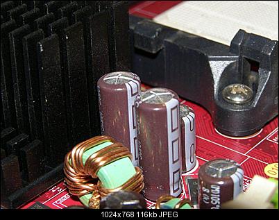

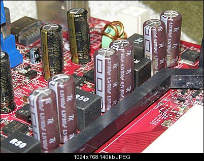

  23. Member lacywest's Avatar
    Aug 2001
    California

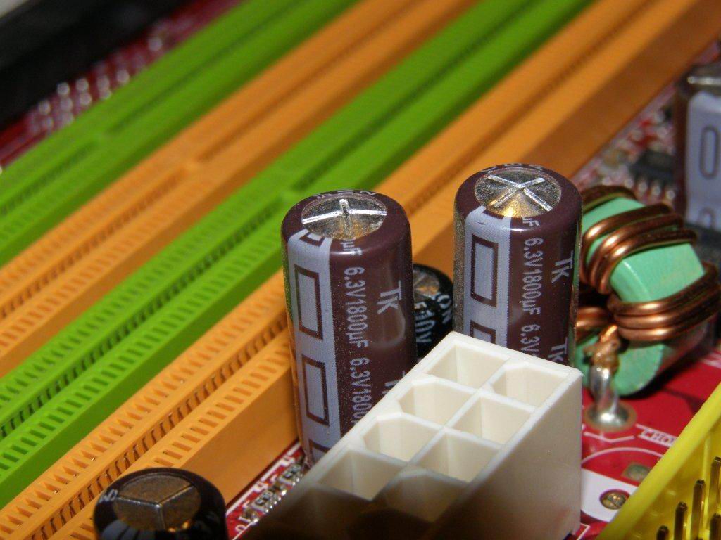

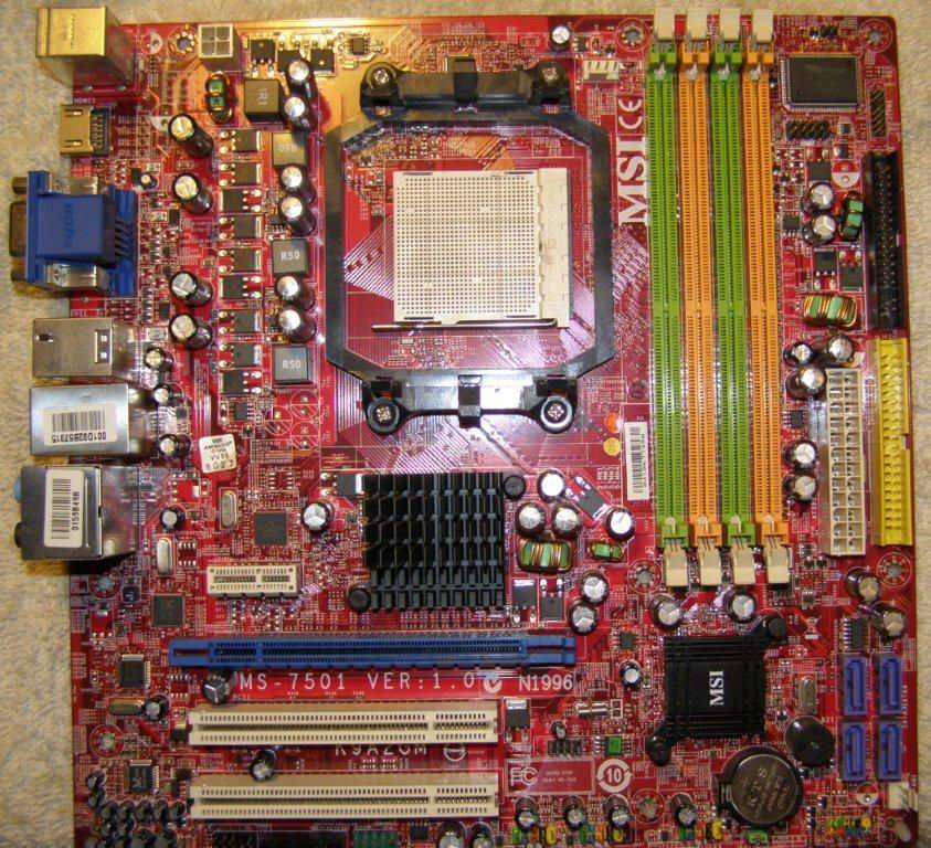

    Badcaps dot come offers a service for 70 bucks to replace the bad caps ... I did not pay that much for the MSI mobo and it was soon at New Egg ... not available ... it is ... was there ... to be bought but not anymore.
    Here are some pix of the bad caps ... 1800 uf ... 6.3 Volts. ... I have some ACER PCs with their mobos out ... they use the same exact capacitors ... and they are not swelling ... I wonder if I can use them. Or should I just get some new capacitors ... at >>> www.badcaps.com ???
