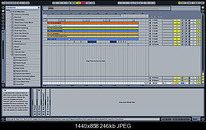

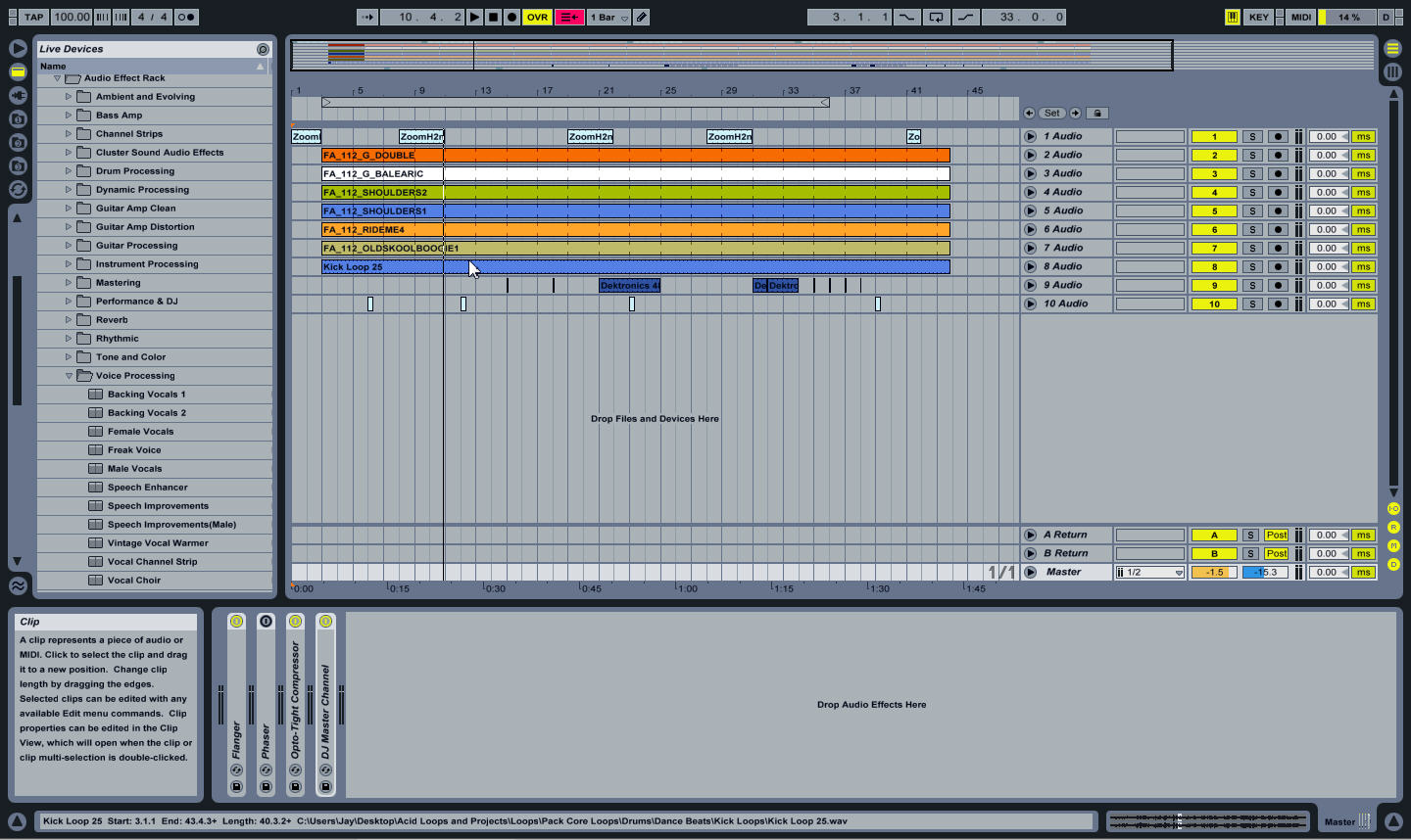

    Maybe the way it samples the clips limits certain things, I don't know.
    Anyway, similar to Vegas, is that there's a lot of controls hidden in plain view. It's much more complicated than it appears, but there is an arrangement view that's linear if you like that look. Look in the upper right corner for two symbols, one goes sideways the other vertical, that switches back and forth.
    Mar 2004
    United Arab Emirates
    [Attachment 9356 - Click to enlarge]
    I actually did test it out, it also changes by pressing TAB key.
    Yes, this view is on the familiar side.
    Just tested it by placing the audio file on it, and yes, it does work as i want it to.
    Thanks for pointing it out.

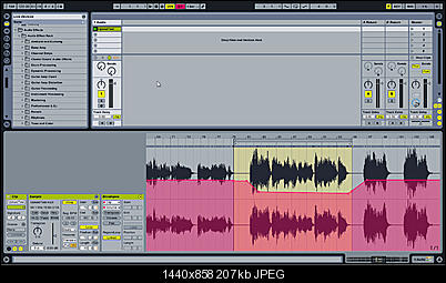

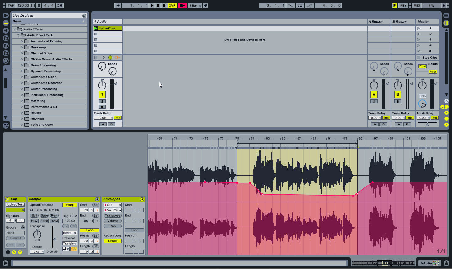

    Did you find the envelope tools?
    Everything can be envelope edited individually. Volume, pan, plugins, all of it. Look for the little "e". In the "Clip" box.
    I'm thinking you were in the arrangement view, and that you loaded the clip there. If so, it won't show up anywhere else. You should load the clip from the mixing screen, then switch over.
    [Attachment 9436 - Click to enlarge]
    Not yet, what does it do ? Whats its use ? How can it be used for Vocals ?

  24. Member budwzr's Avatar
    Apr 2007
    City Of Angels
    Is your computer slow?
    You have to have warp on to edit. Don't worry about it popping, it will render fine.
    Anyway, go to session view and look for the small "E", and turn on envelopes, then go to the little dropdown box and all your effects will be there, and also volume and panning, and from there you make points like Vegas and adjust all the parameters.
    I was under the false assumption that your recording would be ready to take on the effects evenly. Didn't know you had issues during the recording.
    So using these envelopes you can clean it up.

  26. Member budwzr's Avatar
    Apr 2007
    City Of Angels
    Shape the envelopes by making points and curves.
    As far as the jittering, turn off the plugins and see if that stops it. If not, then something went wrong in the beat match. Delete the clip and bring it back in.
