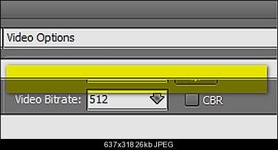

    I'm running Windows 7 x64 and my display of the GUI is not as clean as the first image in this thread when I run the GUI fully maximized. It looks like there is another drop down that's partially covered.
    Image Attached Images
  29. Member ozok's Avatar
    Oct 2011
    Turkey
    @mail2tom, did you strech the GUI? Looks like there is an other bug; instead of staying on the right side, settings resize to left as well.
