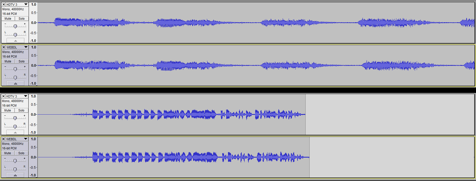

    I've attached a screenshot of Audacity with the two tracks one on top of the other. The first part is zoomed in to a couple of seconds to show that is starts in sync and the other shows the first 20 seconds. As you can see even though you can see from the peaks that it's the "same" audio, it starts to desync pretty fast.
    The closest I've reached of synching them was using the "Change Speed..." option of Audacity but even then it doesn't seem consistent across the whole file so eventually desync again.
    I understand this is close to impossible to figure out but if anybody has any clue of something that might be causing this it would be greatly appreciated.
    Thanks!

    ekred, can you post the original audio to the two files so we can take a look? Put them in a 7z or zip file and upload them to
    mediafire.com . Put the URL in here.
    One file is 15 seconds longer than the other, it seems this is the reason they are not in synch.
    Even though the video's are the same frame rate, there may be a factor in their creation (that we're not aware of)
    that caused it.
