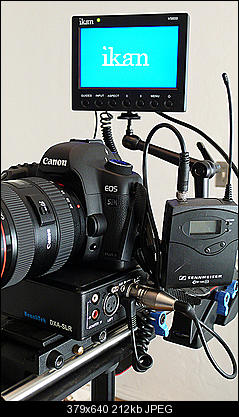

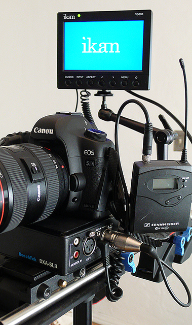

    Better to get a wireless mic (Azden/Nady/etc) designed for a consumer camcorder mic jack. If you go with pro audio you end up with lots of extra boxes and cables like this picture.

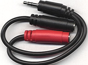

    Yes that should work with the HV30. It terminates in a mono plug. If you get a dual mono minijack to stereo miniplug adapter, you can use two mono mics.
