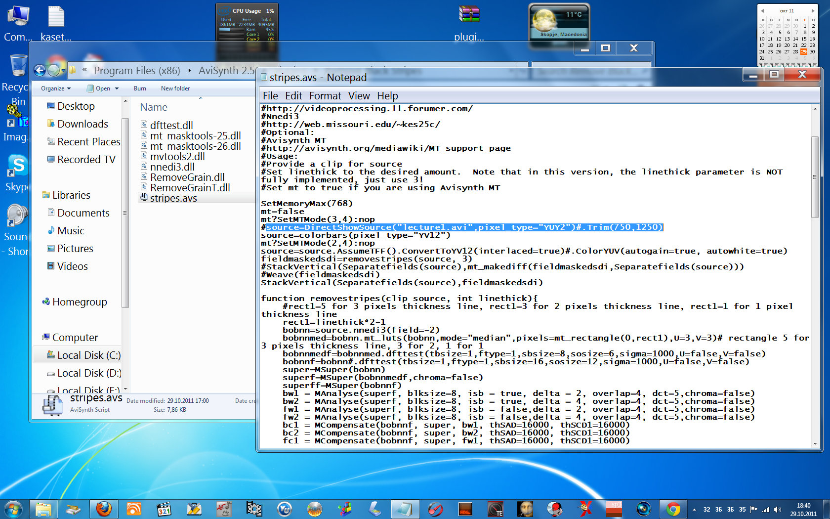

  2. I can tell from looking at the script it needs these; mvtools, removegrain, masktools, dfttest.
    I can confirm that i have all this in plugins folder. Thanks jmac698 is there something missing in my folder that should make this script to work
    Here is picture of my avisynth plugin folder
    and syswow64
    Can you upload the correct version or correct plugins that worked for you for this script

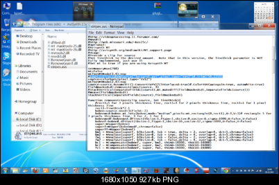

    Thanks jmac698 i downloaded the package and its extracted to my avisynth plugin folder inside is script named stripes.avs
    when i opened I'm confused that the source is with # which means that avisynth should ignore that line
    SetMemoryMax(768)
    mt=false
    mt?SetMTMode(3,4):nop
    #source=DirectShowSource if i put my path here nothing happens wich is normal("lecture1.avi",pixel_type="YUY2")#.Trim(750 ,1250)
    source=colorbars(pixel_type="YV12") ?
    Where should i put my file path should i use something else or just this script that is in my folder is there something that i should know before starting this script. My original file is lagarith yuv2 file 720x576 and is avisource why the directshowsource line I'm also confused.
    Sorry for harassing you but i don't know what to do next after extracting is that all that i should do and just the script in the package or something else.

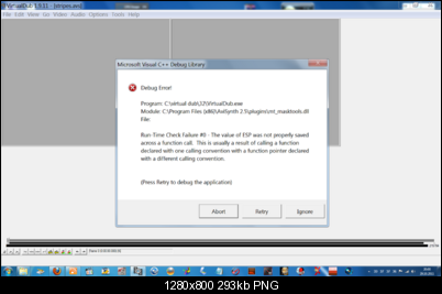

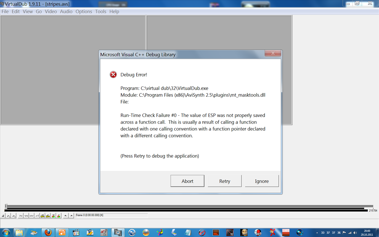

    I figure that out but when i run script in vdub and changed that line to get my file i also changed mt to true instead of false but is the same fault that i get Click image for larger version

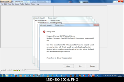

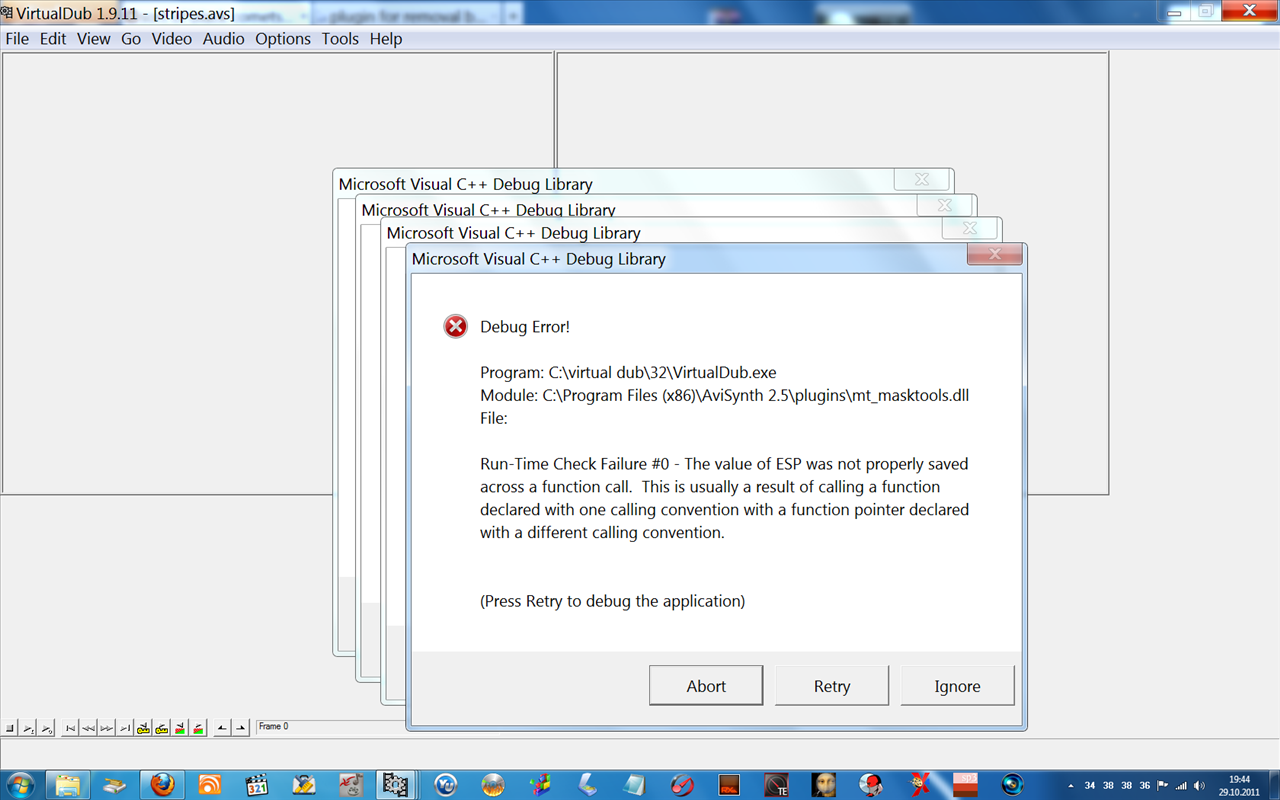

  6. Click image for larger version
    even if i let the color bars i get this error it might be that i have those plugins in plugins directory of avisynth and the package is extracting them in black strikes folder should I overwrite something

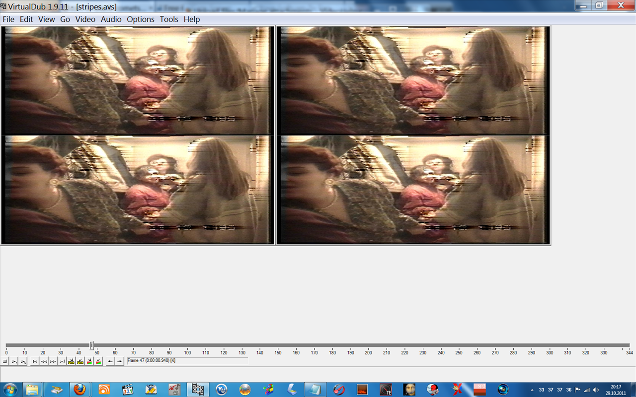

  7. Thanks jmac698 i deleted everything from my plugin folder, and now the script works ( i backed up the plugins temporally in rar ) but i don see that script is doing anything on mine file can you help is there some threshold or other parameter that i should tweak

    I noticed that if the files from the script are alone in the plugin folder the script loads ( its very slow by the way ) but soon as i put another ( any ) plugins in there like mt.dll or other the script is crashing my virtual dub or dub mod programs, something strange is going on.
  10. It could have to do with setmemorymax, try reducing it.

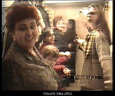

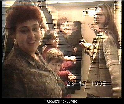

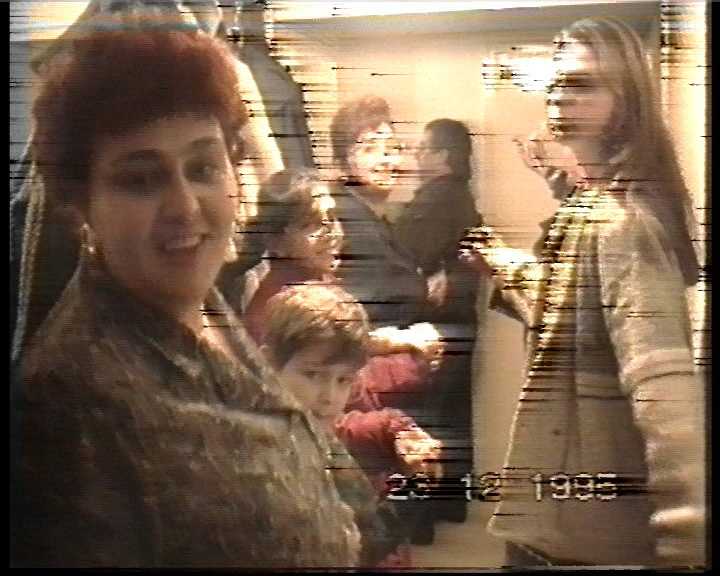

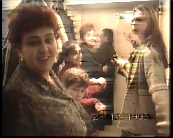

  13. I tried to tweak a little bit the script and this is what i get most of the black lines are gone (or just masked with blur a don't know)
    it blures the picture maybe little too much but is a start. What do you think jmac698
Name:	za crni linii_0.00.01.15.jpg
ID:	9449Click image for larger version
