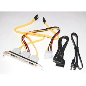

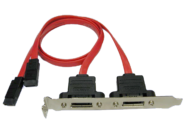

    eSATA is basically the same as SATA in your computer. I use a PCI slot eSATA socket adapter from a couple of my spare internal SATA sockets and a eSATA cable to my eSATA drive enclosures on one PC. (First image)
    And a eSATA PCI card on another with the sockets built into the card. Something like this, though it's a SATA II card: http://www.newegg.com/Product/Product.aspx?Item=N82E16816132021 But it's still faster and more reliable than USB 2.0, IMO.
    There are lots of eSATA hard drive enclosures out there with their own power supplies.
    If you want to do it the quick way, just use a regular SATA PCI slot socket extension and regular SATA cable directly to a bare hard drive, along with a power supply or an extension power cable from the PC power supply. (Second image)
    But the eSATA card or adapter and eSATA cables are a better way to go.

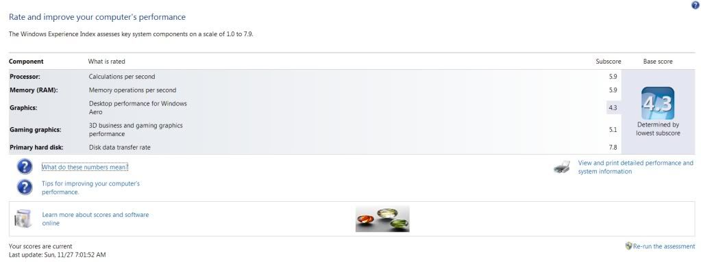

    Further, I finally got a crucial m4 64gb ssd and was wondering if anyone can tell me these numbers mean, i.e, is my ssd performing 'good' given my limited system?
    My Specs are:
    Acer Aspire x3200 w/ AMD Phenom X3 (TripleCore) 8400 2.1 GHz (Stock speed & HS)
    4 GB G·Skill DDR2 800 PC2-6400
    Onboard NVidia GeForce 8200/9200
    Asus Xonar DX
    WD 500GB (30 GB OS partition for 1+ year)
    Windows 7 Ultimate x64 Build 7600
    Now, I'm on a look out for a budget sata3 addon card for my new ssd. I would need one that will allow faster speed than my current SATA2 speed, at a budget price knowing full well i won't be reaching nearly the full sata3 speed, even it I could I doubt I would notice a difference in real world usage. It also must be reliable and have at least one port.
