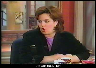

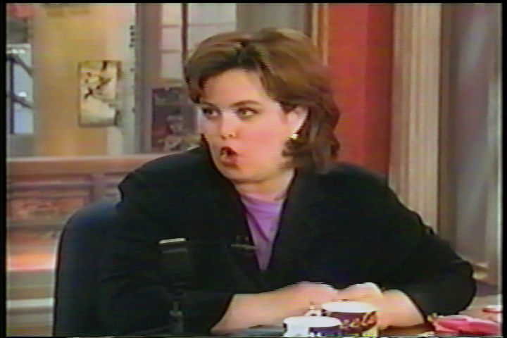

  1. Anybody have any ideas for something to correct the Chroma noise? Still got quite a bit of noise with removedirt+vd's built-in chroma smoother:

    New York, US

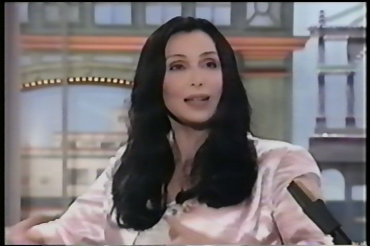

    RemoveDirt didn't leave much to work with (not that there was much image in the first place), but here's the same filters and RemoveDirt v2 (right-hand image) at 4:3 ratio. I don't know, MCTemporalDenoise might clean those shadows a bit better, but. . .they're a little smoother now. The more detail that's removed, the closer we get back to clay-face.
  3. Banned
    New York, US
    I lowered saturation just a teensty notch in the image above. Yes, this is one badly discolored multi-gen dupe job. That lower mkidtone area is a hassle, but I've seen it before. Sometimes it never clears entirely (it can't. Once data gets destroyed, it don't come back). Each shot might have to be tweaked a bit. Very slight adjustments in RGB can make a big difference. But your colors are about in the ballpark.
    VHS, especially when duped like this, often displays odd effects in some portions of the image. Small objects get discolored from chroma bleed from nearby objects. There's some bad edge ghosting, too (no surprise). You can use CSamp to check pixel values in tiny spots, then drag in another curves filter to address small areas. With damage like this, unfortunately, sometimes small bugs just won't give up. My guess about the small side view of Cher's face being discolored is that the bright-hand edge ghost from her hair is responsible. Time for me to learn masking and motion tracking in AFter Effects -- if I can ever get to it.

  9. I think any filter you try is going to remove some bad stuff add add an error because the footage is fragile. I would like to see Removedirt() > VDUB camcorder color denoise, and your color curves. You may be able to do a light sharpen to "unclay" skintones, but sharpening will exagerate some of those multi-gen composite errors at the edges of objects.
    Actually, it's not built-in. The script you're using calls two chroma plugins, but other scripts call different routines. The different plugins do different work in various stages of that script before RemoveDirt's main functions are called to clean up the results.

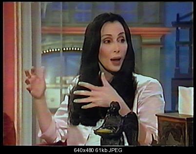

    Rather than any sharpener, I tried lowering the darkest colors and the lower midtones a bit more. It gives the image a bit more punch, but with bad VHS you have to be careful with the extreme ranges. I also added a pinch of dark blue below RGB 20 because I thought the hair verged on turning a bit green, but those hair colors vary wildly. Cher's hair looks a bit more realistic, but her open mouth is turning black. The lack of detail doesn't help, either; more detail can hide a lot of color problems. With so little detail, bad colors are more obvious.
    The "shadows" on Cher's fingertips fall into that low-midrange RGB area I mentioned. Look at how different the colors are in that area. Annoying.

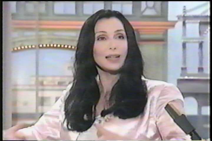

    Mm, that's the biggest problem - the godawful grain in those shadows. If there was a filter that could smooth/degrain only a specific range (from about RGB 30 to 80), things would be peachy (already tried PeachSmoother). Smoothers work on the whole image, not just shadows. After viewing this clip 5000 times this A.M., I'm guessing that at some point during this video's dupe cycle (maybe about the 6th generation? ), somebody sharpened the hell out of this video - so there's ringing, even the ghosting is sharp, and bright detail simply exploded - not to mention some crushed blacks. I've been playing with smoothers/degrainers all morning. Still working. Color balance is pretty much solved.
    There's some bad temporal noise, seen on the front of Rosie's desk and in streaks plus some kind of "flutter" in bright areas. I got rid of that with TemporalSoften and RemoveDirt - in that order; for some reason the two didn't work as well in reverse order. Looked even better with SeparateFields. Does that suggest something about an interlace problem at some point? I suspect so.
    Streaks, flutter, rainbows and exploding streams of color gone. Now for that grain. Every time something moves, the whole place explodes with gnats and sparkles. Color blotching in shadows is on its way out, too. But those rough edges and sawtooth texture won't leave me alone for other work I have to do. Phooey. Going thru AviSynth filter lists now....

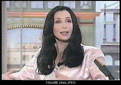

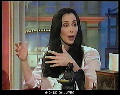

    Frame 354 from the original cap. It's within 16-235 in RGB (the darks are RGB 30 or higher). There's plenty of grain in the shadows on Cher's face and neck. But look at the black mouth. Lower the darks and the mouth looks worse - because there are no details in the midtones or brights. Cher's nose and other features have no detail, but what's there is just plain black. If you smooth those grainy shadows, you also smooth everything else. You end up with skull-head and clay-face effects.
