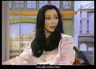

  1. Meaning that my crop integers need to be divisible by 4?
  2. So far this is giving me no problems:
    p1=AviSource("Cher Rosie.avi").ConvertToYV12(interlaced=true).Trim(35 96,3727).Crop(12,4,-8,0)
    p2=DirectShowSource("Cher - Rosie ODonnell Interview 1996.flv").AssumeTFF().ConvertToYV12(interlaced=fa lse).Trim(2942,3051).Crop(32,8,-32,-8)
    p1.WriteHistogram("Cher Rosie.hist.txt", 10)
    p2.WriteHistogram("Cher - Rosie ODonnell Interview 1996.hist.txt", 10)
    AviSource("Cher Rosie.avi").Trim(3596,3727)
    ColourLike("Cher Rosie.hist.txt", "Cher - Rosie ODonnell Interview 1996.hist.txt")
    AssumeTFF()
    MergeChroma(last,McTemporalDenoise(last, settings="very high", edgeclean=true, ecrad=3, stabilize=true, maxr=2, interlaced=true))
    ConvertToRGB32(matrix="Rec601",interlaced=true).Cr op(11,4,-13,0)
    AddBorders(12,4,12,0)
    LanczosResize(704,480)
    Result:

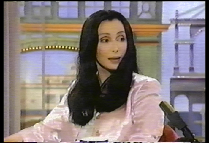

  6. Here's a raw/colourlike'd before/after:
    http://www.mediafire.com/?7bshkti3htawbvr
    Still not perfect but I think it looks much better than it did before.

    Your source was too blue, the utube number was too green, together they "averaged out". Sort of. It's a shame both versions are in such bad shape.
    So, what are your plans for videos in your collection that don't have comparable versions on the internet?
  8. Considering my source was in such bad shape as far as being washed faded and desaturated, I figured this would be the best way to go since there was more color present in the Youtube video...but suggestions are welcome.
  9. The source appears to be heavily noise filtered. There are no small details left at all. Look at Cher's hair for example. You can't see even a hint of strands. Is it that way on the tape too?
  10. Maybe you can take the YT video as a "reference" for colors correction but i wouldn't use it in colourlike clearly.
  11. Banned
    New York, US
    The YT version is far too yellow (people are so orange they almost glow with that hue). The YT clip looks over-filtered as well, just not as much, but at least it has some color density. It looks like a bad tape dub that was oversaturated to make it look "better". Anyway, both sources are something of a mess, there's only so much one can do with either. If the YT was made part of a collection of other clips on DVD, it would have to be resized to match the other clips -- at that point it would lose much of what it might have over the OP's original.

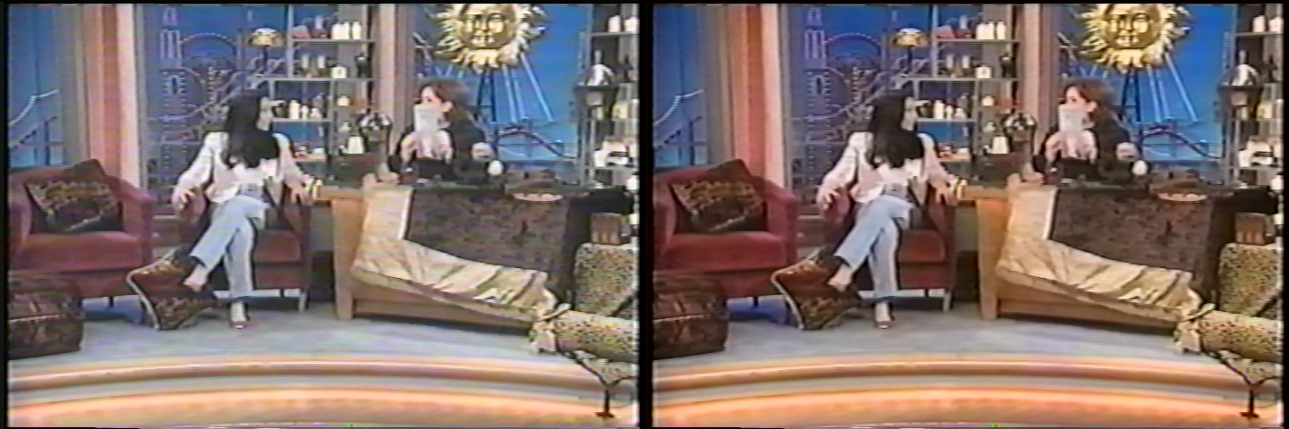

  18. All I see this "colorlike" effort doing is boosting the saturation.
    Try camcorder color denoise in VDUB. Your color noise is very splotchy rather than grainy. camcorder color denoise will work well.
    Also, a good NLE would be better for color correction. Color curves, saturation levels and what have you.

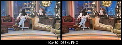

  22. Toying around with Gradation Curves/NeatVideo a bit in VirtualDub...further tweaking still needed but thus far I think it looks a bit better than the ColourLike result:
