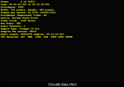

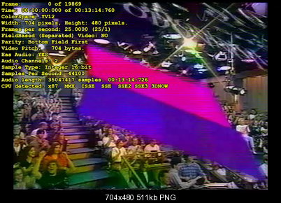

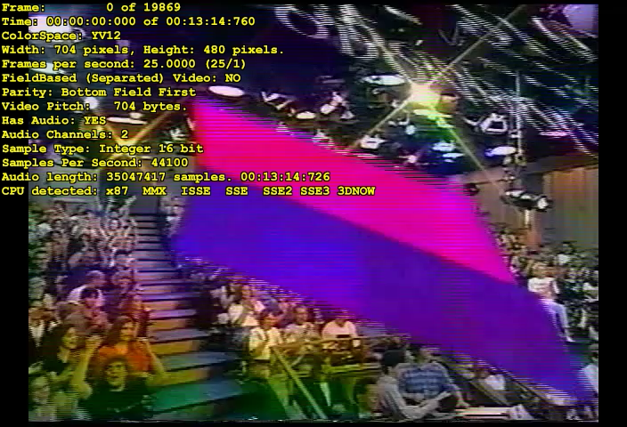

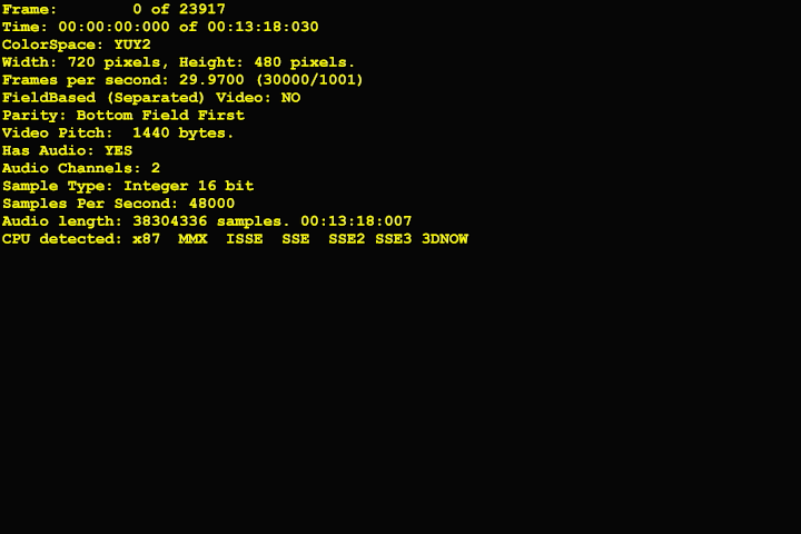

    and just to make sure I opened this and it worked just fine:
    DirectShowSource("Cher - Rosie ODonnell Interview 1996.flv")
    Info()

    Try:
    AviSource("Cher Rosie.avi")
    Info()
    Cher Rosie.avi
