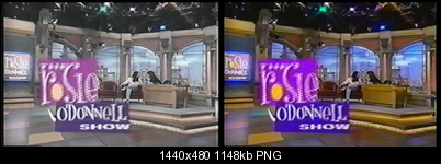

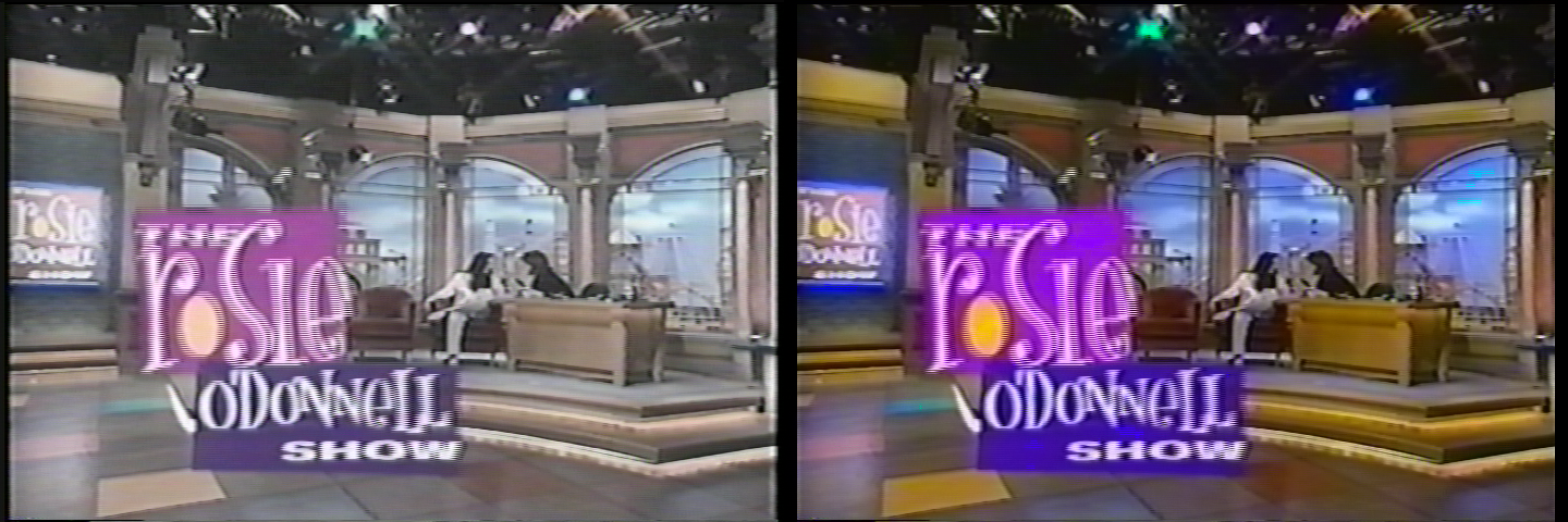

    and here's a before/after...as you can see the blues are a bit too saturated in the resulting video causing the bright baby blue artifacts in the blue background/lights but I'm not sure what to do to correct this. The source was really washed-out:

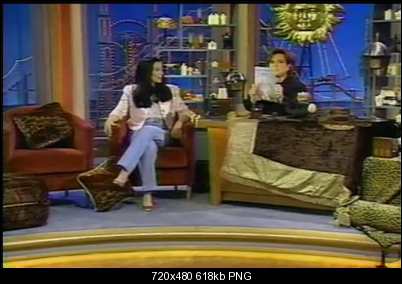

  2. Try cropping the frames so that the two sample image match. And eliminate the black borders. Try toning down yt.png a bit so Colorlike() is less likely to overshoot.
  3. Banned
    New York, US
    ColourLike is less than perfect, but in this case the two scenes are too dissimilar and don't work well with the same histogram. Your png's are interlaced (?). What was your source for the png's? I'm guessing you made a screen capture in Windows (the capture format in clipboard will be non-interlaced BMP, right? Correct me on that one, ye powers that be).
    I've used Colourlike many times, but with scenes that were fairly similar in the type and placement of objects, overall lighting. etc, evn if the color, saturation, levels, etc., weren't that close. When Colourlike doesn't work for whatever reason, you're kinda stuck with knowing how to work with colors and contrast on your own. If you take your "before" scene in YUV and reduce brightness, correct levels, increase saturation, it should be closer to the "after". The colors look mostly like RGB errors (but this doesn't mean you can't fix 'em in AviSynth).
    If you read the pixel color values on furniture and other objects in the vt.png scene, you'll see that the pixels in the before and after scene don't have color values near those in yt.png. Those artifacts likely come from Colourlike trying to match scenes that are too dissimilar. Also, the "black" area in the top of the before shot was too light but is closer to black (about RGB 46 46 46 in most areas) than the "black" in the after shot, which is a bit short on blue. The levels in the after shot are better and the color is probably closer to what you want, based on yt.png, but there's no reason you couldn't get there from the before shot without Colourlike.
    I'd try another histogram sample at step 1.

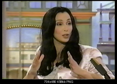

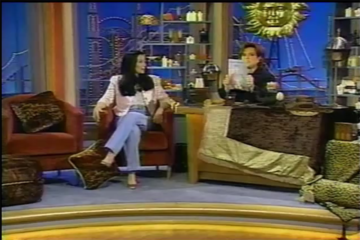

  16. Well I was going to upload a screen cap of my latest effort but every time I press upload a red exclamation point pops up and it doesn't upload the PNG
  17. Ok I finally got it to let me upload. Here's a screencap of the "ColourLike" result with no further tweaking as of yet except MCTemporalDenoise:

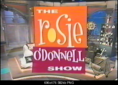

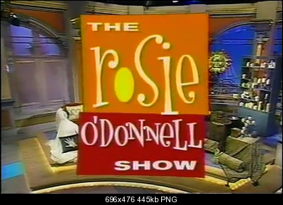

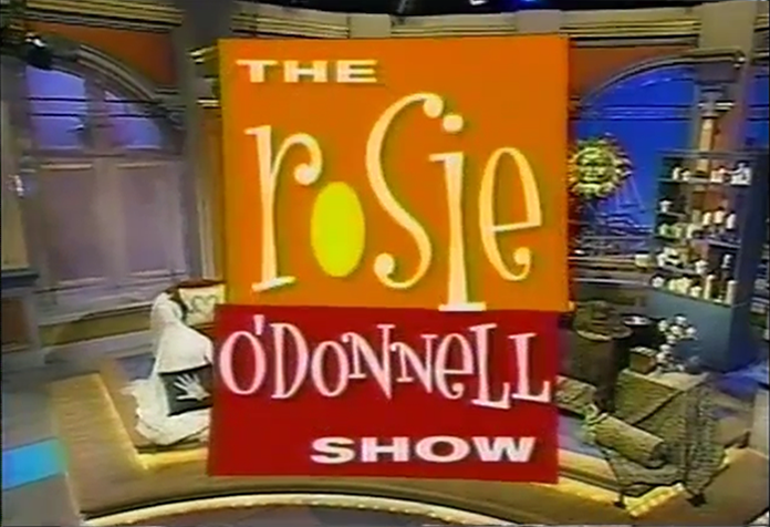

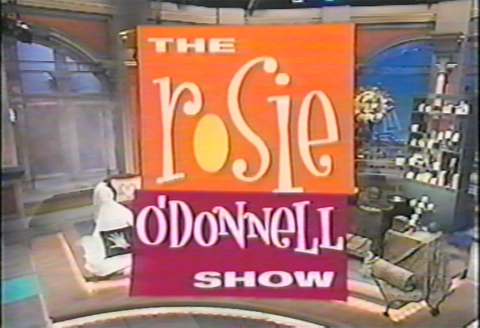

    And I used these two caps for ColourLike:
ID:	9260Click image for larger version

    I don't quite get what you're trying to do here with ColourLike. The scenes in the two title shots have nothing in common with the closer shot with Cher. There's no reason why the two shots should "look alike".
  19. Banned
    New York, US
    There are pics of 3 scenes above, not two. Which scenes are the source for the two hist.txt files? You have two title-card shots, yt.png and raw.png. You then introduce an avi named Cher Rosie.avi, but Colourlike is looking at histograms for raw and yt, not for the shot of Cher's face.
    I think you were trying to use the histogram from the title-card caps to make the scene of Cher match the title card scene. The script did this:
    1. Scene A posters (the master histogram you want to emulate) = write histogram as A_hist.txt
    2. Scene B posters (histogram of the scene that will be modded) = save as B_Hist.txt
    3. Scene C Cher (modify B posters to look like A posters, then change C's colors/levels to look like modified B poster colors/levels)
    The effect would be to make Cher's face look like the colors in the poster shots.

    Also....when I tried to use one of the stills of Cher's face for yt.png as a reference for colourlike it gave me the oddball artifacts in some of the colors like I mentioned before. I was curious if I can use more than one raw/yt video clip or still to make several histograms for colourlike. Jagabo mentioned using video clips instead of stills but I'm not entirely sure how to perfectly align my raw vid and the youtube vid. I've been aligning the still frames used for colourlike in photoshop that way I made sure I had perfect alignment.
  22. Banned
    New York, US
    That's the same script you posted earlier, with yt and raw reversed. You still have 3 shots instead of 2.
    You're trying to make ColourLike correct every scene in your video with a histogram from a single frame. Like using the same YUV and RGB filter settings and the same script for all scenes and every video, it doesn't work.
    Why not try adjusting these scenes on their own, without ColourLike?

    I see 3 caps in that post: two shots of the title card posters, and one shot of Cher. The two shots of the posters look different in levels and saturation, so I take it they're from 2 separate shots (?). If they're actually the same shot, why don't they look alike? The "3rd" shot is Cher's face.
    From your post I take it to mean that you used the same histogram to fix the shots of the posters and to fix the shot of Cher you posted above them as the "result." So, what does the video "Cher Rosie.avi" segment actually contain? Did it have multiple scenes that included shots of the posters, shots of Cher, Rosie, Cher and Rosie together, the full-stage shots, and everything else? What sample histogram did you use for the Cher image?

    ConvertToRGB32(matrix="Rec601",interlaced=true).Cr op(11,4,-13,0)
    AddBorders(12,4,12,0)
    LanczosResize(704,480)
    That's the script I am working on for using video clips for the histograms instead...but for some reason I keep getting an error. Hmph...gonna keep toying with it. For one thing I don't think the youtube clip is interlaced...and it's 25fps...my raw capture is 29.97fps and interlaced.
  28. Originally Posted by sanlyn View Post
    I must be not understanding something *scratches head* I only see the raw.png and yt.png in my script...where does the third one come into play?[/QUOTE]
    From your post I take it to mean that you used the same histogram to fix the shots of the posters and to fix the shot of Cher you posted above them as the "result." So, what does the video "Cher Rosie.avi" segment actually contain? Did it have multiple scenes that included shots of the posters, shots of Cher, Rosie, Cher and Rosie together, the full-stage shots, and everything else? What sample histogram did you use for the Cher image?[/QUOTE]
    Yeah the first one of her face I posted was the "after" when I used the two caps of the title card (one from my video and one from the youtube rip) to ColourLike but now I think I'll try to sync it up to moving video. I suppose I could try and correct it without using ColourLike but I figured my source was so incredibly washed out and desaturated that this method might be a little better. But there again I'm still learning here so you guys know better than I do
