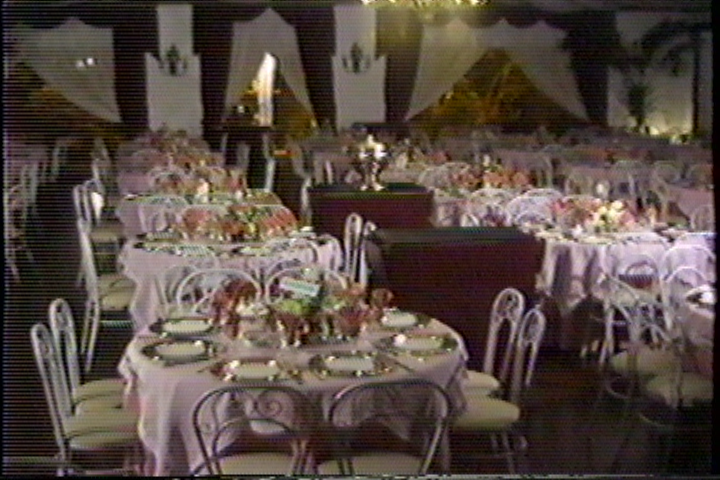

    This was captured as I always do.. dscaler with "simple weave" using lagarith (720x480i) from my VCR.. no processing at all..
    When I use bob deinterlacer in virtualdub I get a field which seems to be also interlaced.. when zooming it shows horizontal black lines which rolls from bottom to top..
    What the heck is going on??!! How can I repair this? QTGMC would help? This is the tape from a friend's 15yo birthday.. there is another tape with this same content and same problem.. (they both must be a copy)
    Please download this sample.. it's lossless (lagarith).. http://www.megaupload.com/?d=JL1V8W0H
    The attached pic is a FIELD.. which obviously shouldn't be interlaced(!).. grabbed from virtualdub output after bob deinterlacing

    It's got nothing to do with interlacing - it's noise/interference, either when the video was shot, copied, or captured. I bet it's been there all along - it's not so noticeable when watching the video at normal speed.
    There might be an fft3d filter setting for just this kind of thing, but I don't have a clue. You could ask at doom9.
    FWIW I think your capture would look better with a line TBC - there's wobbling and distortion. But that's a separate problem.

  6. If you're forced to work with the video as-is you can "fix" it with this:
    AviSource("ampex-cut.avi")
    SeparateFields()
    Blur(0, 1.0)
    Sharpen(0, 0.7)
    Weave()
    Or:
    SeparateFields()
    VInverse()
    Weave()
    At the cost of a little blurring.
    Note that VirtualDub has problems with interlaced YV12 video. I would convert to YUY2 before giving it to VirtualDub.
    SeparateFields()
    VInverse()
    Weave()
    wow, thanks, this vinverse() was fantastic.. no horizontal stripes anymore

  12. There's a pattern of two light lines, two dark lines, two light lines two dark lines... all the way down the video. They swap with every frame. There's also a discontinuity in the middle of the video.
    The above filter chains work by separating the fields, leaving each field with alternating light and dark lines. Then the lines are averaged together so that they have equal intensity. Finally the fields are woven back into interlaced frames.
