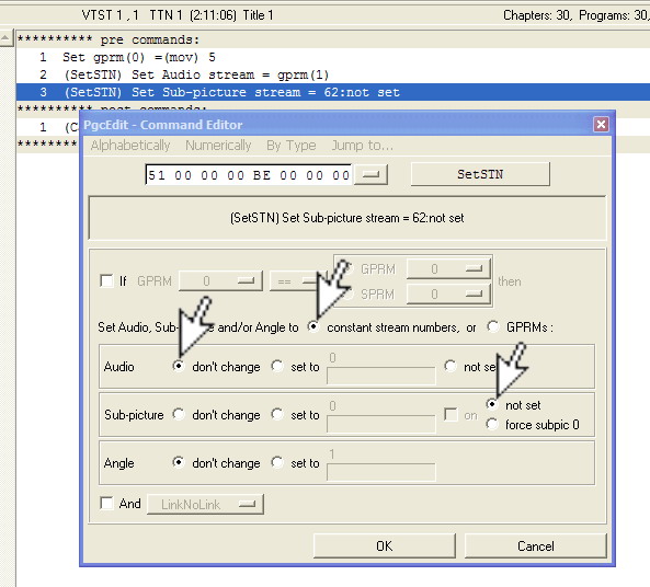

    I'd need a little help in turning subtitles off by default on a DVD.
    I know there's the 2COOL's guide but in my case there is already a SetSTN command.
    What's the procedure in this case?
    Here it is a screencap of PgcEdit:

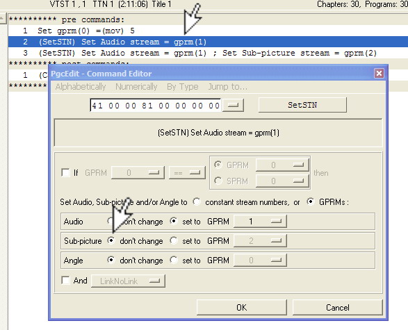

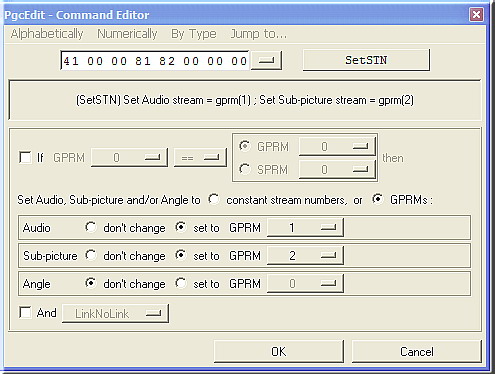

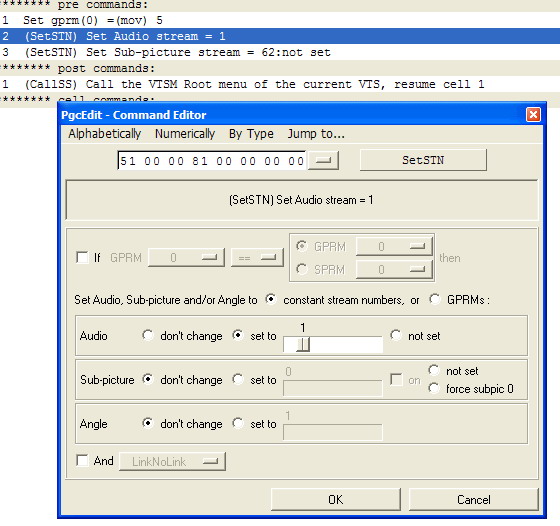

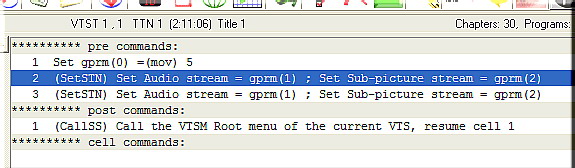

    1) Copy 2nd line command and "paste after" . You get third line with the same command as shown in picture #1.
    2) Double Click on 2nd line command as highlighted in picture #1, you get editor box as shown in pic #2.
    3) Change Subpicture setting as shown in pic#3 and click OK button. You will get changed command on line 2 as shown .
    4) Click on line 3 and adjust settings as shown in pic#4, click OK button.
    Done, Save DVD
    You can still choose subtitles using remount control's subtitle button.

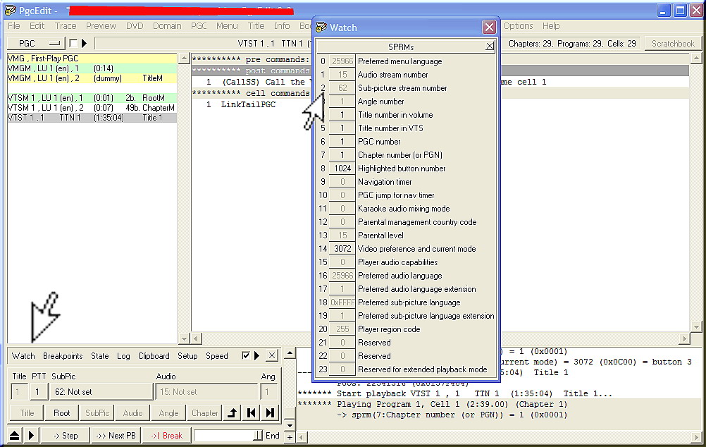

  21. I don't know if this is exactly what you wanted but I traced to the subtitles menu and selected the Italian subs.
    Here it is what I got:
    ******* Playing Program 1, Cell 1 (0:00.12 + infinite pause) (14 buttons)
    -> sprm(8:Highlighted button number) = 14336 (0x3800) = button 14
    Selected menu button: 14
    -- button : (SetSTN) Set Sub-picture stream = 3, on ; LinkTailPGC
    -> sprm(2:Sub-picture stream number) = 67 (0x0043)
  22. Member
    Oct 2006
    Canada
    OK. It looks like menu selected right subs.
    See picture.
    Click on Watch, it will expand, select SPRM and run trace all the way till it start to play your title. See if SPRM2 stay at 67.
    If that is the case, than your DVD player has a problem reading right stream.
  23. No, it reads 62.

  28. It is also possible that the player gets confused by the order of the subpics. In my example of a gap at position #1, it considers subpic #2 as being subpic #1, subpic #3 as #2, etc. Apparently, it's what is happening here.
    This is equal to DVD Shrink remapping the streams.
    I usually don't remap because it messes up the buttons in the language/subtitle menu.
    But in this specific case it's useless since I added a command to set subtitles off and the buttons don't work anyway.
    My old player (I don't even recall its obscure brand) had no problem with "gaps" (other problems but not this one), contrariwise to the player I have now (Pioneer).
    If it's not the case, it is highly recommended to enable the "Logical remapping of enabled streams" option of DVDShrink.
    But I would lose the possibility of using the buttons, wouldn't I?
    I mean, I'll be able to select the streams only via remote control.
  29. Member
    Oct 2006
    Canada
    I am not sure if you are referring to the old file or new one I send you.
    The old one had a command in a Precommand of the Title and that override any previous commands. As I mentioned later, you can get subs back with a remount only .
    Second file should be OK. I ran trace in PgcEdit and it worked fine with all the buttons. Not sure how it will behave after shrinking, because as r0IZ mention, there is more to it how players interpret removal of certain sections.
