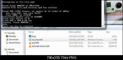

    looks like the gopro fix works here.

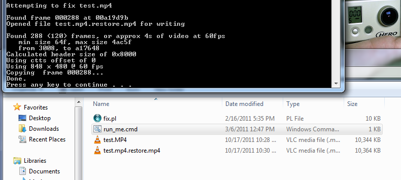

  14. Tried the AVI program, no sucess...
