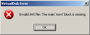

    Even with loading with the FFDS option enabled, none of the files are viewable in VirtualDub.
    The .m4v's show scrambled video with or without the FFDS option on load. The .mp4's are black screens: without the FFDS option there's noise at the screen's bottom; with the FFDS option there's one blue pixel.

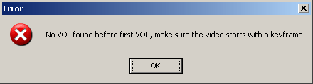

    And with or without the FFDS option on loading, the .avi's give me this error:

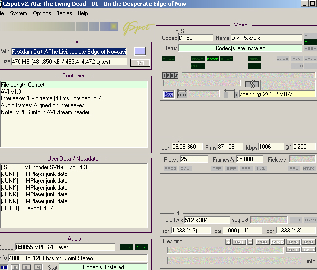

    In case it might be helpful for someone to look at it, I've placed one of the files at
    http://www.megaupload.com/?d=SHPZ9950

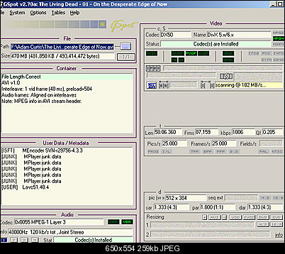

    It is 466MB. I'll close with it's details (and a plea for more help, please):

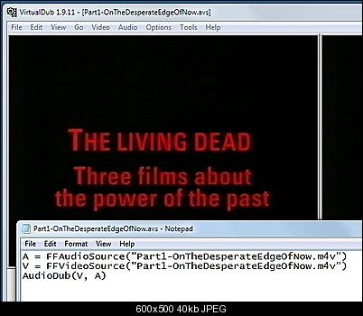

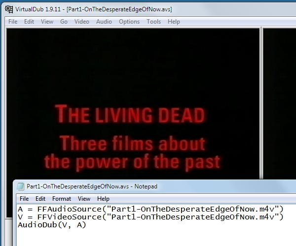

  15. M4V is essentially the same as MP4. What error are you talking about? The black screens? Use the DirectShow plugin. I'd even get rid of the MP4 and MOV plugins.
    VirtualDub just isn't a good editor for MP4 files. For reliability I'd use AviSynth and ffVideoSource() to open MP4 and M4V files in VirtualDub.
    A = FFAudioSource("filename.m4v")
    V = FFVideoSource("filename.m4v")
    AudioDub(V, A)
    If you only want the video it's just:
    I'm referring to this
    error I got when trying to load the .avi files.

    But in all likelihood you will have to resort to the DirectShow input driver or use AviSynth.

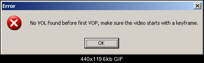

    I tried the (helpfully described) "simple remux" with VirtualDub. My USA Philips 5992 still wouldn't play the result, even if I then used WinX2D to change the fourcc (from DIVX) to XVID or DX50.
    When I tried to load the file into Mpeg4Modifier, this error resulted:

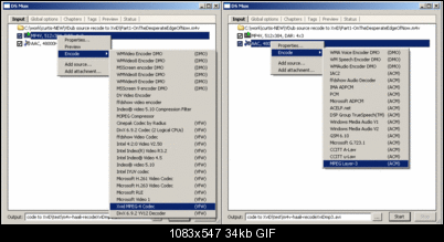

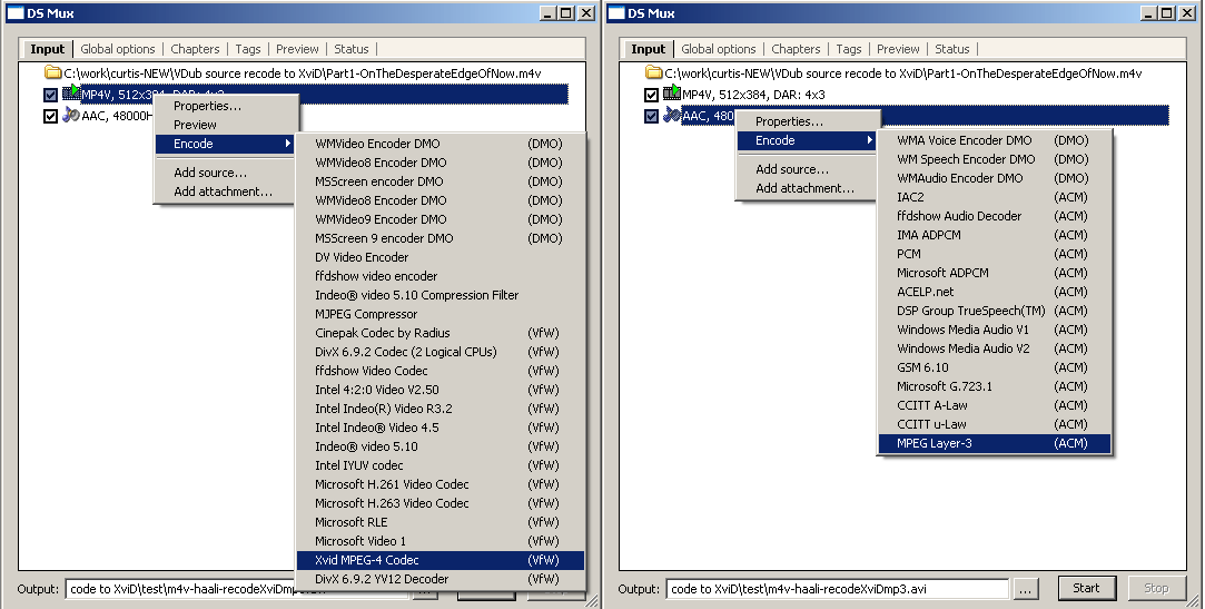

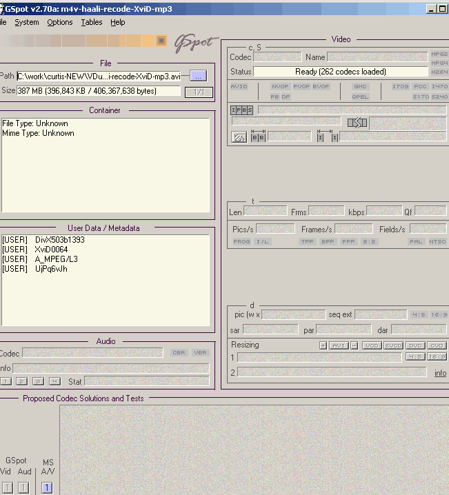

    I used Haali to recode the .m4v to .avi, with these selections:
    (Or I think I did--the window title was "DS Mux" instead of Haali)
    However, the resulting .avi file does not play on my Philips 5992 (or my other standalone); it does play with VLC.
    To create the .avi I typed "filename.avi" into the Output field; is that the way to tell it to create an .avi file?
    (When adding the Input source via Right-click, I had to change the File Open window's "Files of type" from "Media files" to "All files", which is less than reassuring, but the program then displayed the video and audio lines pictured. ffdshow video and audio icons did display in the tray; output file was 20% smaller than input)
    Here's details on the output file:
    Here's the MediaInfo paste:

    I also looked at a suggested alternative:
    I wonder: would this be better than using Haali for the recode?
    (Are VirtualDub's problems with m4v/mp4 files avoided using Avisynth with VirtualDub?)
    If so...
    Using VirtualDub's DirectShow input driver, or AviSynth's DirectShowSource() requires that you have a DS file reader, DS file splitter, and DS codecs that can handle the file.
    Where would I get those three DS components, please?
    [Attachment 9387 - Click to enlarge]
    [Attachment 9386 - Click to enlarge]
    If so...

  29. Gds_mux created an MKV file -- you just named it with the AVI extension. The Philips 5992 won't play that. The audio and video in that file look to be compatible with the 5992. Have you tried just remuxing into an AVI with AviDemux?
  30. Member
    Mar 2008
    Oops! Thank you very much, yet again, jagabo!
    I did not (even suspect AviDemux might be an option). Now I've tried with AviDemux:
    Simple remux (Video & Audio = Copy, Format = AVI, ".avi" extension manually typed for filename) resulted in a 5992 message that "audio codec not supported". So I changed Audio from Copy to mp3: the 5992 played the audio but without any video.
    Next I also changed Video to "MPEG-4 ASP Xvid" and both video and audio play on my 5992!
    (Assuming that I now want to recode [rather than remux], and that AviDemux is a choice to do so with, perhaps the final advice I'd love now is...)
    Are the codecs I happened to just use in AviDemux ("MPEG-4 ASP Xvid" and "MP3 (lame)") good choices (in terms of compatibility and quality), and if so I'd love any tips on how to configure the:
    mp3 Audio (lame): I believe I understand I want the mp3 to be stereo CBR. I know 320 kbps is the highest quality: is it inadvisable for compatibility? (It appears to me that Quality = 0 would be most desirable, and is just an internal algorithm so I guess not relevant to compatability.)
    MPEG-4 ASP Xvid: I see the same 1 to 31 Quantizer scale on which jagabo explained to me the merits of "3" for the other file up thread. Are any other settings (or a filter) advisable, please?
