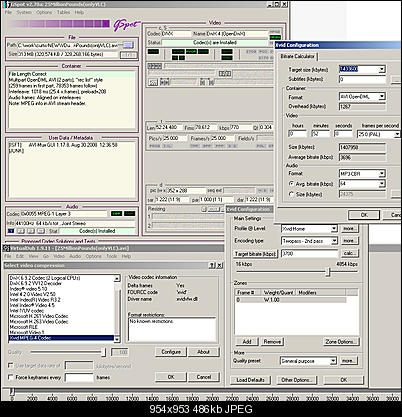

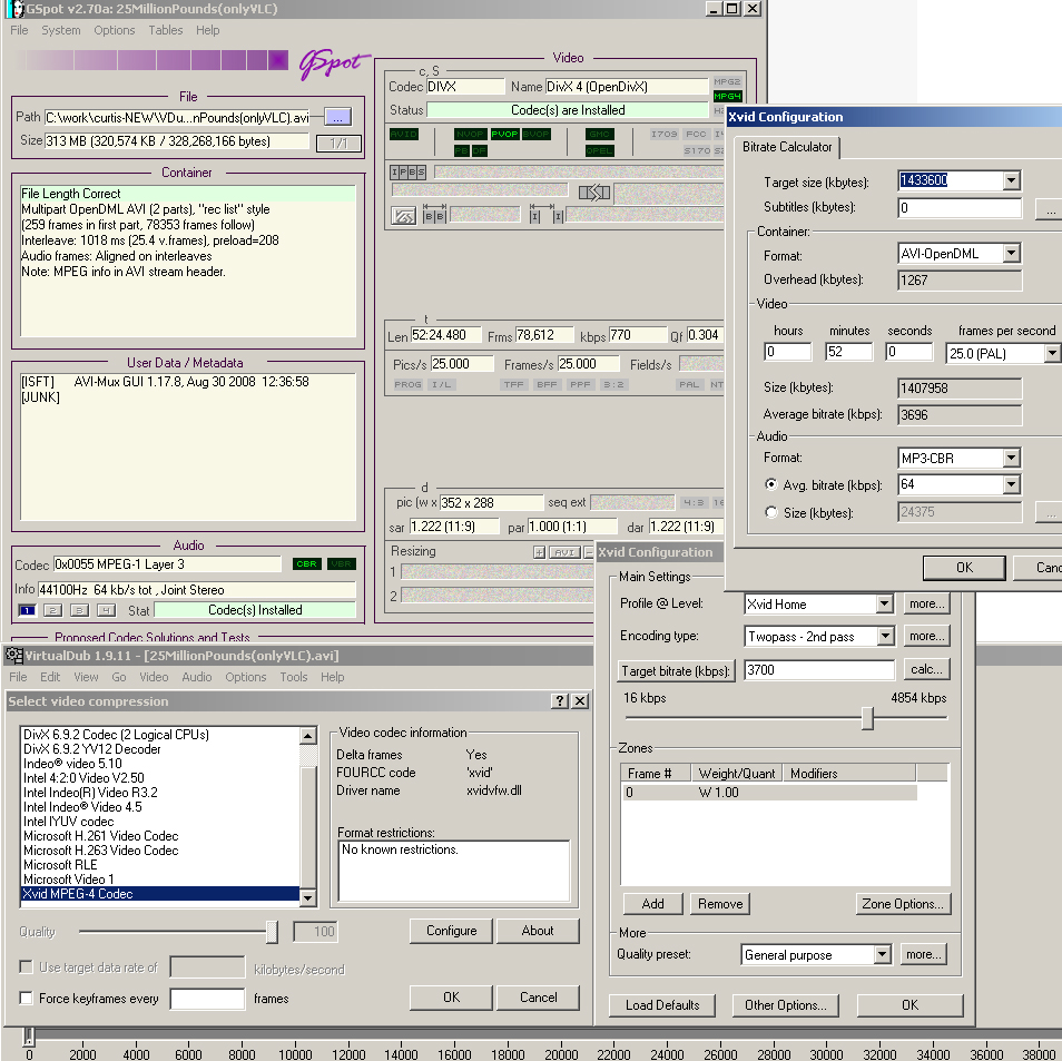

    I'm trying to convert two sets of files (one set DIVX, one set DX50) to XVID.
    (Because until I do, they won't play on at least one of my standalones, and I want everyone to be able to play them. So perhaps it's a separate issue why my Philips 5922, which I think should play them, won't. [Before or after I did the 4.1.1 firmware hack by vb6rocod.])
    But when I follow the instructions here (Option 1) to convert to XVID using VirtualDub 1.9.11, on the second pass the output saved is only 1/10 the size of the original.
    I chose the the largest Target Size offered by the Bitrate Calculator (I'm happy for it to be as large as is advisable).

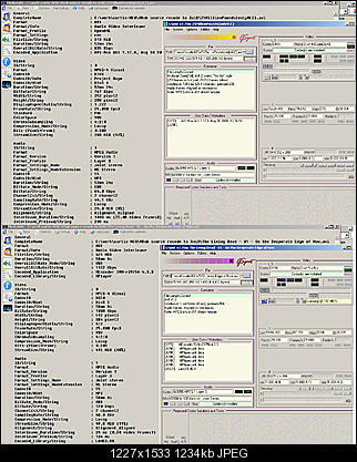

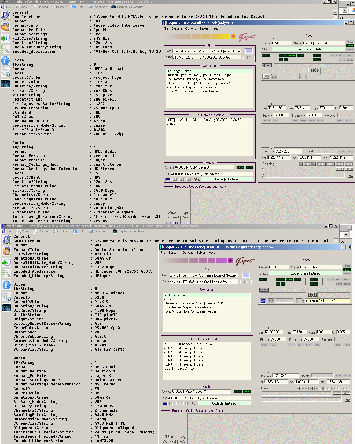

    That is the GSpot for the actual file I'm having a problem with. I'll follow with Mediainfo too, for both sets of files.
    Mar 2008
    Here are the GSpot and MediaInfo for one from each sets of files:
    The first file is available here: http://www.archive.org/download/AdamCurtis-25MillionPounds/25MillionPounds.avi
    I would be happy to provide a smaller sample of it, or of the other file, if that might help.

    Try it this way.
    Open the file in Virtualdub and open the video compression/xvid. Hit the button "load defaults"
    Set the encoding type to 2 pass 1st pass (and enter 770 in the bitrate if it is not greyed out)
    Leave audio as "direct stream copy"
    file/queue batch operation/run video analysis pass.
    Re-enter the xvid config and set the encoding type to 2 pass - 2nd pass. Enter the bitrate of 770 if it is not present.
    file/queue batch operation/save as avi - give it a name and location.
    File/job control - you should see the two jobs. Hit start and wait for them both to finish.

    Just as a side note - for MediaInfo, use Tree View (text) when checking your videos. You can then copy the information from there and paste it into a post as plain text, if need be. No need to push multiple windows into a single image file capture.
    (It would probably also be better if you captured and posted each GSpot window as separate images. )
    Mar 2008
    Thank you Ai Haibara, from now on I'll post the info as you recommend. I appreciate that it would be more readable that way.

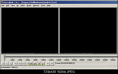

  12. I just ran a single pass target quantizer (constant quality) encoding with the quantizer at 3 (on the file linked to in post 6, no filtering, fast recompress), otherwise the default settings, and got a 441 MB file.
    I followed up with a 2-pass encode at 770 kbps (same as the source) and got a 314 MB file, as expected.
    How does your reencoded file look? Is it all black? Are you sure you ran both passes of the 2 pass encode? 1/10 the size of the original sounds like the results of the first pass -- a black video (which compresses to nearly nothing) and the audio.
    Mar 2008
    What is the bitrate of the new file?
    Overall bit rate : 88.1 Kbps
    What does Mediainfo say? Put it into view/text mode and include it here.
    Complete name : C:\work\curtis-NEW\VDub source recode to XviD\test\2stpass25MillionPounds(onlyVLC).avi
    Format : AVI
    File size : 33.0 MiB
    Duration : 52mn 24s
    Writing application : AVI-Mux GUI 1.17.8, Aug 30 2008 12:36:58
    Writing library : VirtualDub build 32842/release
    Video
    Format : MPEG-4 Visual
    Format profile : Advanced Simple@L5
    Format settings, BVOP : 2
    Format settings, QPel : No
    Format settings, GMC : No warppoints
    Format settings, Matrix : Default (H.263)
    Muxing mode : Packed bitstream
    Codec ID : XVID
    Codec ID/Hint : XviD
    Duration : 52mn 24s
    Bit rate : 14.4 Kbps
    Width : 352 pixels
    Height : 288 pixels
    Display aspect ratio : 1.222
    Frame rate : 25.000 fps
    Standard : PAL
    Color space : YUV
    Chroma subsampling : 4:2:0
    Bit depth : 8 bits
    Scan type : Progressive
    Compression mode : Lossy
    Bits/(Pixel*Frame) : 0.006
    Stream size : 5.39 MiB (16%)
    Writing library : XviD 64
    Audio
    Format : MPEG Audio
    Format version : Version 1
    Format profile : Layer 3
    Mode : Joint stereo
    Mode extension : MS Stereo
    Codec ID : 55
    Codec ID/Hint : MP3
    Duration : 52mn 24s
    Bit rate mode : Constant
    Bit rate : 64.0 Kbps
    Channel(s) : 2 channels
    Sampling rate : 44.1 KHz
    Stream size : 24.0 MiB (73%)
    Alignment : Split accross interleaves
    Interleave, duration : 40 ms (1.00 video frame)
    Interleave, preload duration : 500 ms
    Yes I am sure. In fact I've repeated it 8 times, both in batch mode and as separate steps. (As separate steps, pass 1 = 28MG, pass 2 = 33 MB)
    Hmm. Maybe VDub is somehow "stuck" in first pass mode even when I select 2nd pass. Perhaps I should un/re-install?

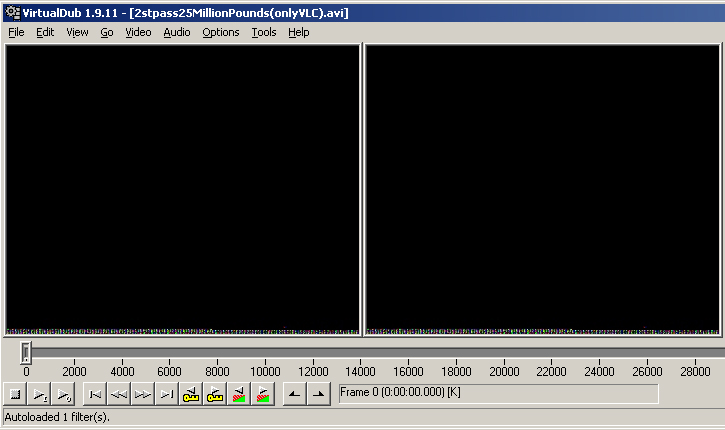

  15. If you scrub through the source file in VirtualDub do you see the video? Or the same black window with a little noise at the bottom?
    Mar 2008
    I suspect you've nailed it! (Which isn't to say I know the diagnosis.)
    Because while I don't understand "scrub through", I tried everything I could think of (play input button, all the other buttons, the slider) to move around the file while playing, but I see nothing but black except for one blue pixel. Ditto when I re-downloaded the source file from archive.org.

    Mar 2008
    Sounds good, got to the bottom of it. Holding the shift key and dragging the pointer at the bottom.
    is a good test. If you don't get a good image, not worth encoding. For some reason the source is not decoded properly
    and that needs to be fixed before you go any further.

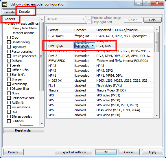

  18. Yes, there's something odd about the way it's encoded. 32 bit Xvid with 32 bit VirtualDub can't decode it properly on my system either. 64 bit Xvid and 64 bit VirtualDub have no problems with it. ffdshow is also able to decode it properly. You can install ffdshow, enable its Divx/Xvid decoder, then 32 bit VirtualDub should work properly.
    Mar 2008
    Interesting! Now I see how my VirtualDub could have problems that jagabo didn't have (at first).
    (I was wondering if something went wrong with my installs of the DivX and/or Xvid codecs.)
    Sweet, I'll do that, thank you very much jagabo and davexnet!
  20. Originally Posted by coyote2 View Post

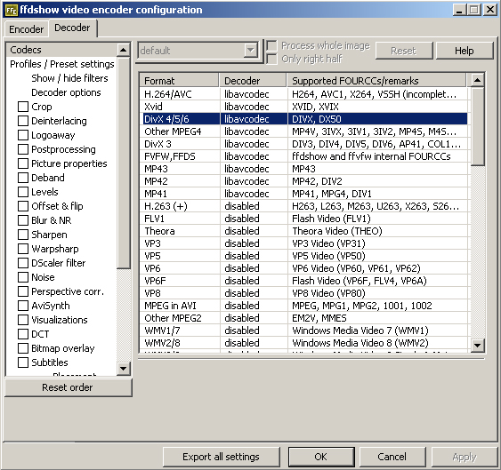

    Remember VirtualDub uses VFW codecs so enable the VFW decoder in ffdshow. Start -> All Programs -> ffdshow -> VFW Configuration.
    Mar 2008

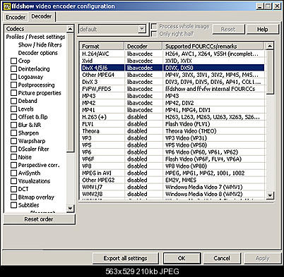

    Thank you very much, jagabo! I installed ffdshow, and I've looked for the settings you mention, but I don't think I've found them (even after reading AfterDawn's "ffdshow Installation and Configuration" guide) since VirtualDub still isn't showing me that file.
    In "VFW Configuration", in it's Decoder tab, I don't see "VFW" anywhere (except the format FVFW which already isn't disabled [Decoder = libavcodec]).
    As for enabling the "Divx/Xvid decoder" they too (on the same screen) already aren't disabled, and Decoder = libavcodec).
    I made sure to tell the ffdshow installer I'd be using VirtualDub. I've looked at every ffdshow setting and I can't guess what I need to do; I can only guess that with so many settings, I must need to do something more.
  22. Member
    Mar 2008
    In the decoder tab, hilight "codecs" (top left)
    ON the right hilight xvid and set it to libavcodec
  23. After selecting Start -> All Programs -> ffdshow -> VFW Configuration select the Decoder tab, highlight codecs at the top of the left pane. Then locate Divx 4/5/6 in the right pane and use the pulldown to select libavcodec.
    I recommend you also select the Encoder tab, highlight "Tray,dialog & paths" in the left pane, then enable "Tray icons" in the right pane (modern or classic). That way an icon will appear in the system tray any time ffdshow is in use. You'll know for certain if the player or editor is using ffdshow to decode the video or audio.
  24. Member
    Mar 2008
    [Attachment 9216 - Click to enlarge]
    Thank you very much davexnet and jaagbo. However, those settings were already that way when I first looked at that screen.
    (As I tried to report in my last post.)
    I love that, thank you! I was particularly concerned about audio codecs (and thus later I plan to set audio decoder Merit = Unlikely), since audio editing is my primary field.

    Does ffdshow open the file now?
    You can check with file/info, and of course, you should have a picture now.
  28. It looks like ffdshow's VFW decoder doesn't put an icon in the system tray (only the encoder). But VirtualDub does show ffdshow as the decompressor when you look at File -> File Information.
    Another thing you can try if you have VirtualDub's DirectShow source filter installed: use the Files of Type pulldown to specify DirectShow Input Driver when you open the file. That way DirectShow will decompress the video, not VFW.
  29. Member
    Mar 2008
    Try it this way.
    File/open put a check mark in the box "ask for extended option"
    Select the source file.
    In the import options screen check off "force video codec handler fourcc to" and enter FFDS in the box.
    Yes! Thank you very much, I do have a picture now, what a relief!
