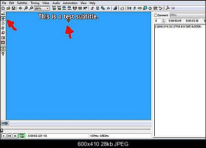

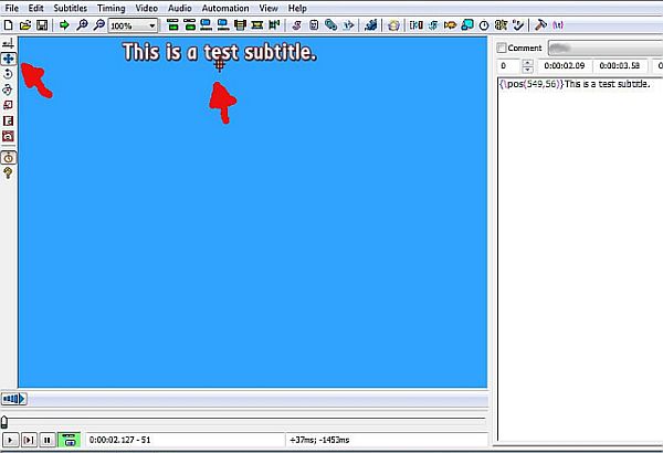

    For experimenting with positioning in Aegisub, with your subtitle file and video loaded (Video menu > Open Video...), highlight the line you want to reposition (in the script in the bottom half of the window) and click on the "Drag subtitles." button to the left of the video display. A small crosshair will appear below the subtitle line's display on the video, which you can drag around to reposition the line.
    Or, you can do it manually by adding the pos command to the beginning of the subtitle line you want to position (notice the example command in the right side of the image, above, and experiment with the values).
    Edit: You may want to save using the .ass format rather than .ssa... .ass is the 'latest version'/extension of the format, and I don't know if .ssa supports all of the positioning features you can use in Aegisub.

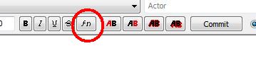

    Highlight a line in the script (don't do this with more than one line at a time), then press the "fn" button ("Font Face Name", to the right of the font style buttons).
    This will open a dialog where you can pick the font to use for the line, and the font size. Don't forget to click "Commit" afterward, though.
    Alternately, you can add the fontsize command to a line (example: {\fs48} )
