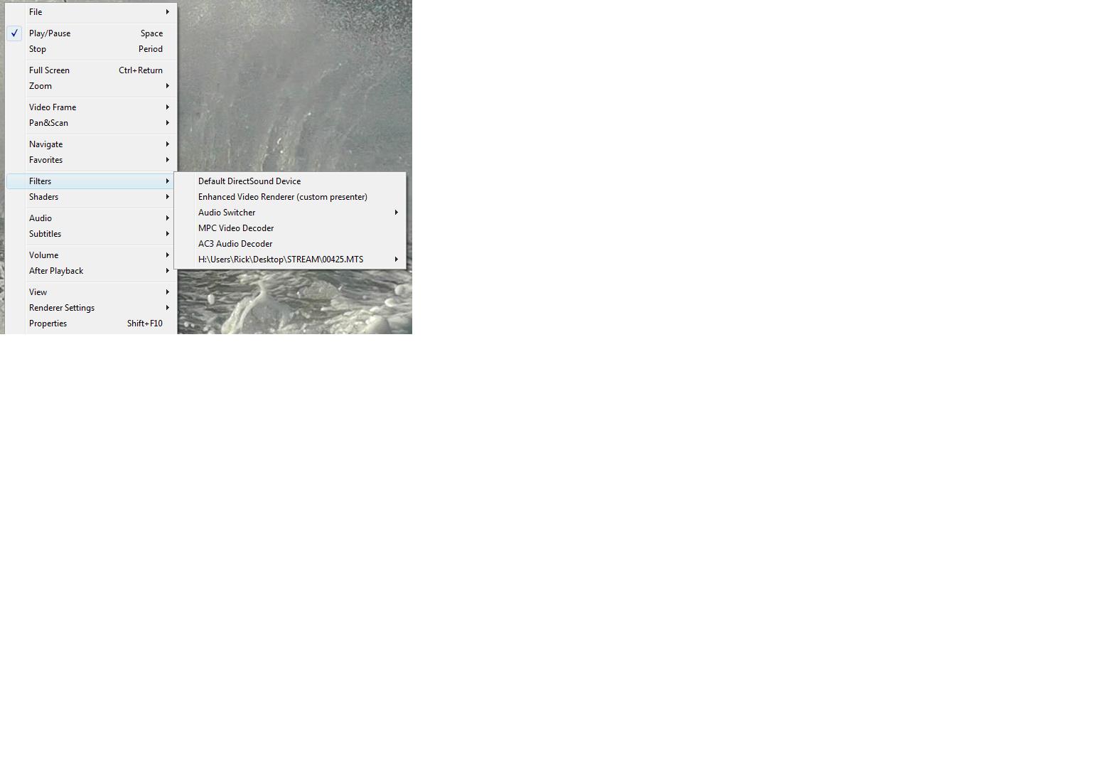

    Mar 2008
    When the video is playing, right click and select "filters". Is the MPC video decoder being used?
    Is DXVA active at all?
  7. Not sure I understand what you mean ... if I right click it shows the screen shot attached
    Mar 2008
    On the right window you see MPC video decoder.
    You have to click on that, another window opens up.
    What does it say for "DXVA mode" ?

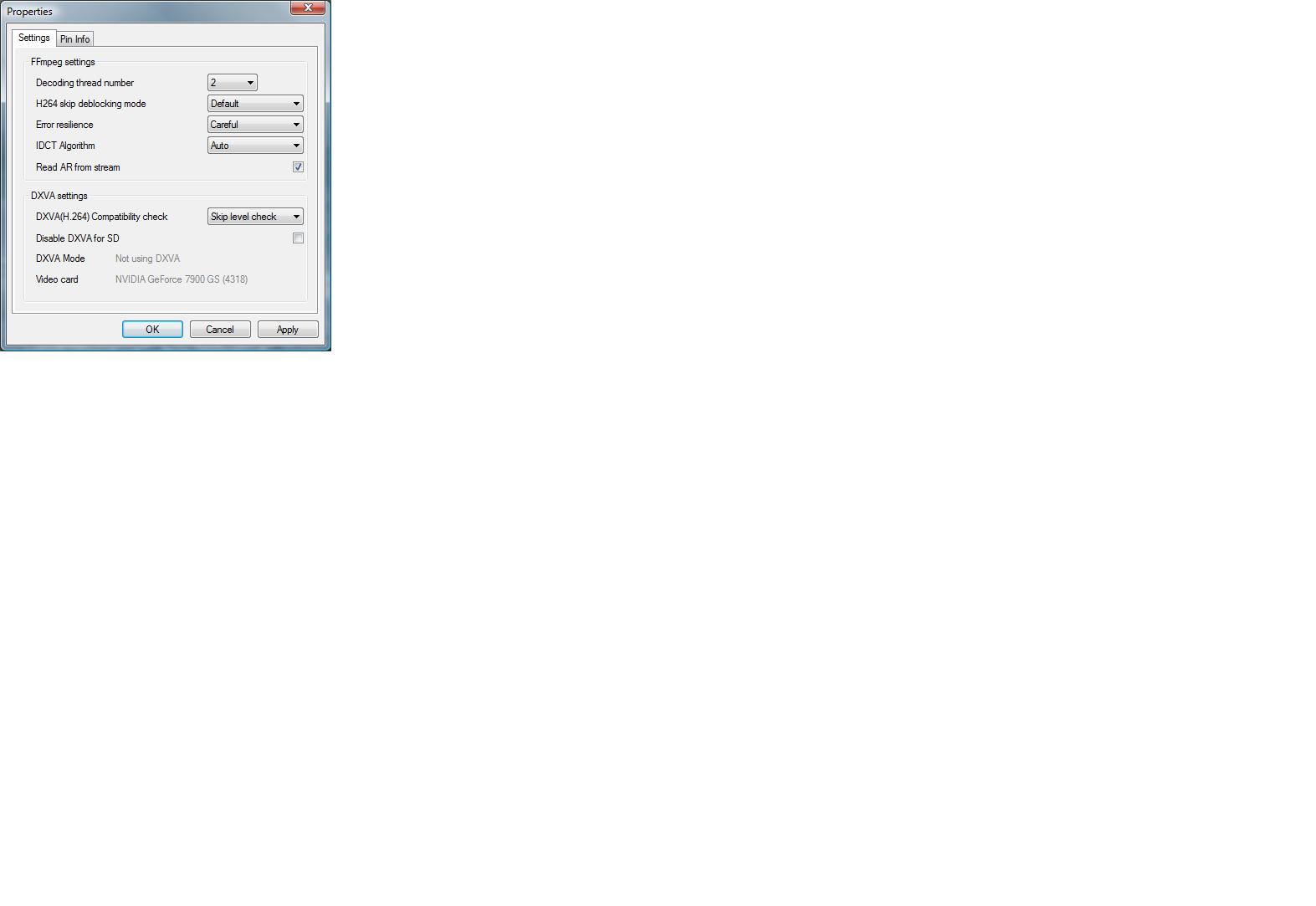

  9. What 'right' window ... then I run files it only open one window ... a full screen video of file playing ?
    do you mean this
    Mar 2008
    Yes - notice it says "not using DXVA" ? This means it is not using any video acceleration.
    Although it could be the file. You should open the media file with mediainfo and put it into view/text mode and place the info here.
