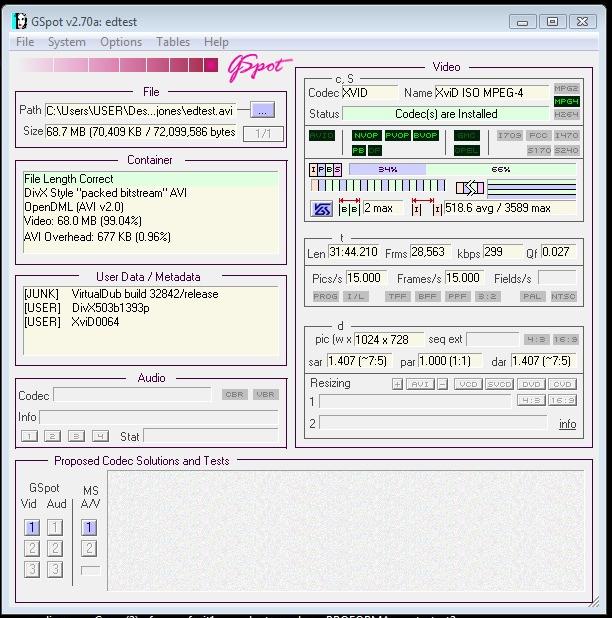

    Here is the Gspot report

  4. Your video has a much larger frame size, 1024x768 and is going to require more bitrate than a video with a small frame size. You either have to reduce the frame size or live with a larger file.
    How do i reduce the frame size (i am new to using virtualdub but learning ) and what frame size would you suggest .
  6. In VirtualDub: Video -> Filters... -> Add -> Resize -> OK. Set the size you want. Try 512x384 (half, both dimensions)? If your source video is very sharp use Precice Bilinear as the filter mode. If it's not very sharp try Precise Bicubic or Lanczos3.

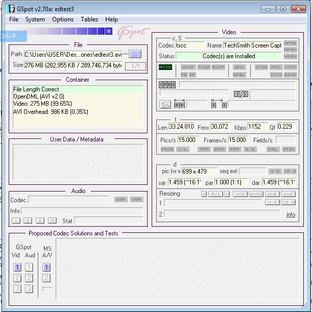

    Hi I tried your suggestion for the 68MB video and it worked i got a 46MB video not so small but at worked . However i have a problem with another file a 276MB AVI file . I tried compressing this with virtualdub but an error message saying "cannot start video compression , an unknown error occured" . Here is the gspot report .

  8. It's probably a resolution thing. The vertical resolution and horizontal resolution both need to be multiples of 16, or else XviD will not work. For example, a 256x256 file will work fine, but a 256x255 will not.
    For the 276 video you mentioned, I recommend 704x480. Try it and see.
  9. Xvid doesn't allow odd frame sizes. It requires at least multiples of 2. Some decoders may have problems with less than multiples of 4. It's most efficient at multiples of 16.
