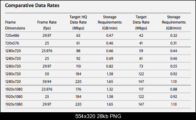

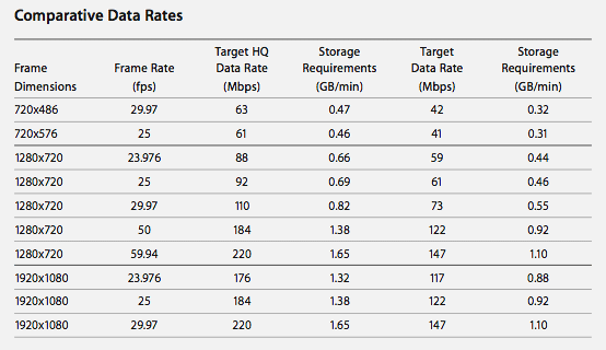

    Prores 422 won't work on a conventional server the bit rate is too high. Normally an expensive SAN server is used for shared video networking in a post house.
    ProRes422

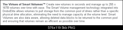

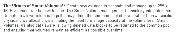

    I perused the Drobo site, and they seem to cater to Mac people because it's a lot of sizzle and few specs. And they like to "Brand" common functions as their own invention.
    Don't get fooled into paying a whole bunch for seemingly impressive features. Every NAS has user share control and JBOD. None of them require managing physical drives, whether JBOD, striped, mirrored, or RAID, to create shares.
    My consumer-level NAS has "Smart Volumes" too.
    No doubt Drobo is highly scalable, to accommodate HD video, but it's still just a NAS.

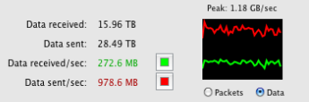

    And FWIW this is a screenshot of my Mac Pro running OS X Server as an example of what OS X can do. BTW those are capital "B"s, as in Bytes/sec.
    Image Attached Images
