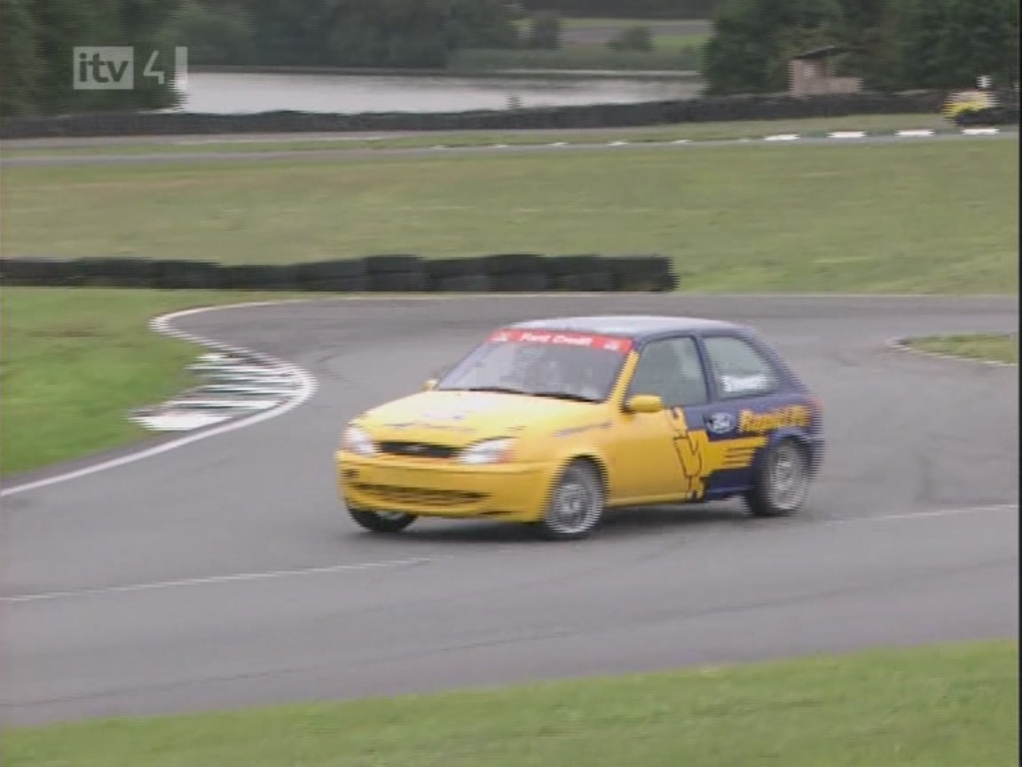

  1. I've got the KMPlayer installed and this is taken from a "live" programme, but when I play it in the KMPlayer, it adds a filmized look to every file.
    This image uses the "bob" from FFdshow... and the lines are obvious.

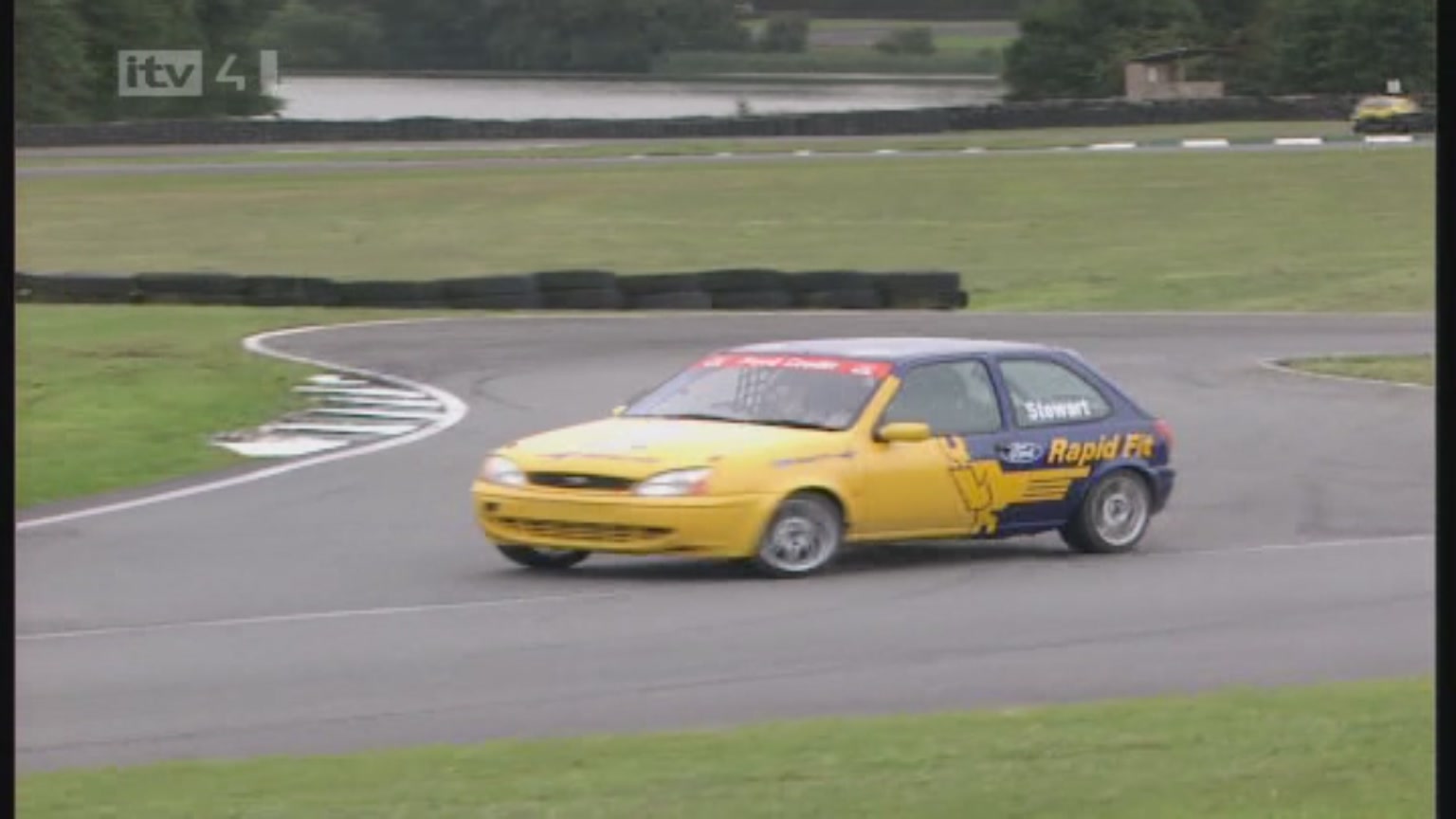

    This one is using the Gabest filter and Bob, and is smoother, and looks less filmized, but I've heard it's not the best codec (Apologies for the aspect ratio coming out wrong, it's meant to be 4:3, but the bits in-between, i.e. adbreaks are 16:9)

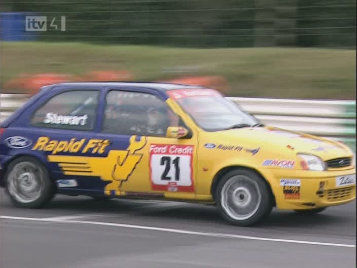

    This clip shows the lines from the "bob" effect.

  4. You want to bob the video to 50 fps. That will give you glassy smooth playback. I don't think KMPlayer has a bob deinterlacer in its output device. You have to enable it in the internal video decoder. That means you must be using the internal decoder, not a DirectShow decoder. In the preferences dialog select Filter Control -> Decoder Usage -> Internal Video Decoder. On the General tab make sure the decoder you need is enabled (MPEG 2? h.264?). Then on the Advanced tab try setting the Libmpeg2 Deinterlacing to Auto Select or Bob. Exit and restart the player.

    Yes. The one that I find works best is Yadif with Double Frame Rate enabled.
