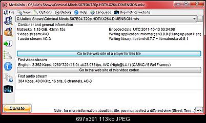

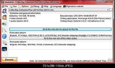

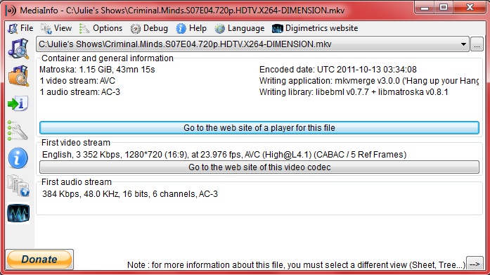

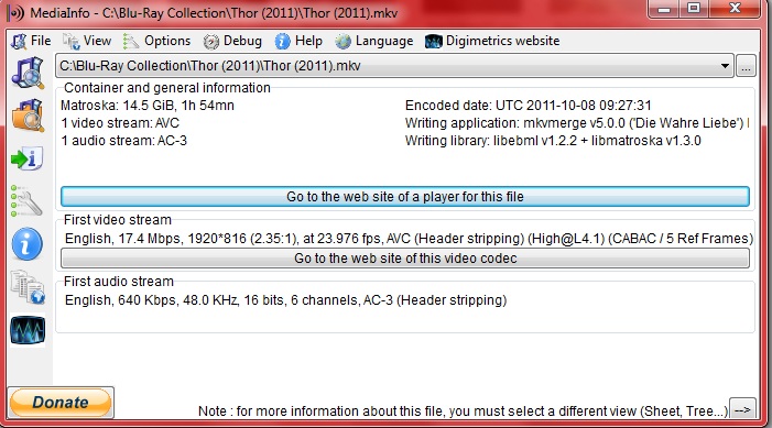

    I have a new Samsung 3D Blu-Ray player which plays media through a USB. My problem is, I played Hawaii Five-O and Terra Nova no problem which is .mkv but, as soon as I try to play a film, Thor for example in the same format it gives an error saying File Format Not Supported. The manual states that the player supports .mkv and as I've already said, I've already played the above TV shows. Are the films encoded in a different way from the TV shows or is there another reason why the films won't play?
    Any help/advice would be appreciated thanks
  2. Banned
    Freedonia
    TVs and DVD/BluRay players that play MKV files don't play everything that an MKV file could possibly contain. Install MediaInfo and post here a screen capture of what it tells you about the file that won't play and someone can probably figure out what the problem is.

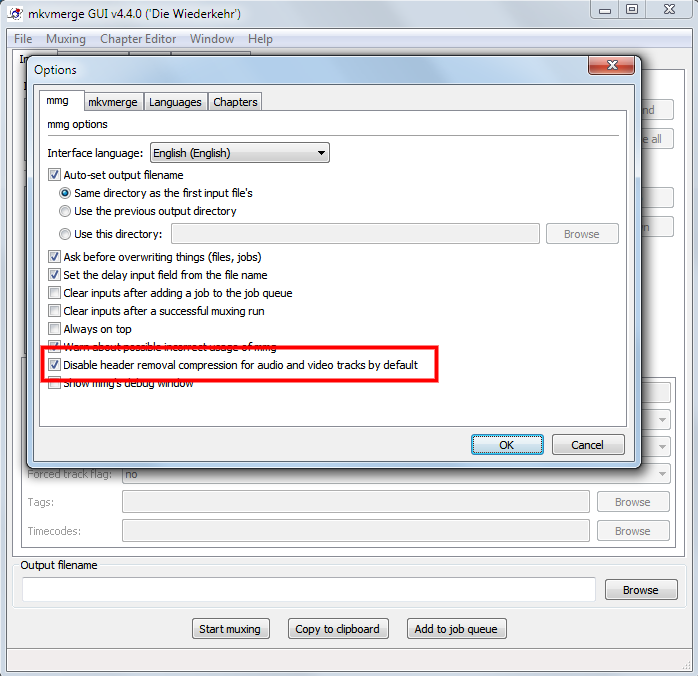

  4. "header stripping". Remux without it. With MMG:

    So just add film to MMG, tick that box and start muxing, is that right?
  6. Yes. You have to exit and restart MMG after ticking the box.
