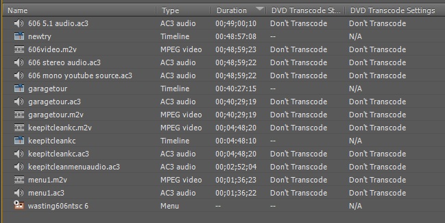

    One more issue though, the main footage went into Adobe encore just fine, no re-encoding or problems with the output, still the same 23.976 with 2:3 pulldown but encore doesn't seem to like that footage for motion menus, it re-encodes them (badly) to 29.97fps interlaced and are out of sync with the audio, the video runs too fast.
    What is the correct method to encode to 29.97i before adding them to Encore? Quality isn't too much of a problem, it's only for the motion menu but I'd like them to be in sync.

  20. soft pulldown works fine for timeline and motion menus in encore, it should say "don't transcode" when it passes through
    You probably have mismatched settings somewhere, like PAL settings (maybe since you are in UK). Double check your project settings and menu settings
    Jul 2007
    Looking it up it appears to be a bug with encore. found this posted on the official forum:
    In my experience, if you're using a multi-page menu with a looping video asset behind it, Encore has the following bugs (which I've already reported via the official form):
    • The video asset is always transcoded, even if it's in a perfectly legal format and Adobe recognizes it as not needing transcoding.
    • The video asset is always transcoded to 30p. If you feed it a 24p or 30i file, it will get transcoded to 30p, no option to override.
    If you're not using multipage menus, you might have better results.
    I assume he is only talking about NTSC projects though because I've made PAL multi page motion menus before and they've stayed 25fps.
    It's definitely all set up as an NTSC project and the assets all say don't transcode but it seems the above bug is causing them to be re-encoded. I'll test it out with a single page menu, see if that does make a difference.
  22. Interesting... But you would think Encore doesn't use HCEnc...I just did a quick test with a single page motion menu - if it is re-encoding, then it shouldn't say "Writing Library HCEnc" in the metadata of the authored VOB now would it ? I would imagine it would be written over if it was re-encoded - this is not the case here . I think you have something set incorrectly
    I'll try a multi menu to see if I can get it to re-encode
  23. Member
    Jul 2007
    It is something funky on my end then. I just tried again, single motion menu, all of the input media was 23.976 w/ pulldown.

    Clearly re-encoded. Bizarrely with a 2.35:1 ratio as well, but doesn't show when viewing. Apart from choosing NTSC as my project when I start what other setting could cause this? Also as mentioned all assets including the menu file (menu1.m2v) are listed as 'don't transcode'
    [Attachment 9139 - Click to enlarge]
  24. Yeah that's weird. What version of encore ?
    It's working ok here, even on multi menu. I even tried low bitrate test (if Encore re-encoded, you wouldn't expect it to retain the low bitrate)

    Did some more searching on the adobe forums and think I found the problem:
    1. If you import a pre-transcoded m2v file as the motion menu background asset, and only have button highlights in the Encore menu (this means no text layers or other graphics in the menu PSD), then Encore will not re-transcode that background asset.
    2. If you import a pre-transcoded motion background asset and apply any kind of text, images, or anything at all in the menu besides highlight layers prefixed with (=1), (=2), or (=3), then Encore will have to render those graphics into the background and re-transcode (double compression = very bad).
    So does that basically mean unless the motion menu is basically the full video with just buttons on top it gets re-encoded? Certainly sounds like it. I am wanting some image overlays.
  26. Originally Posted by Killer3737 View Post
    LOL of course...how do you think something like a PSD overlay would become DVD compliant?
    I build everything into my motion menus. So if you wanted overlays or effects, do that in another program like AE as part of the actual video

    I don't know really, I thought it would do something clever so the video just sits behind the jpg. Or something.
    I guess I'll just settle for the re-encode then, I wouldn't have a clue how to add the overlays to the video itself.

    At least 1 encode is necessary. How else do you overlay a jpg on a video? (Even if you disregard menu or no menu, or even if you disregard DVD-Video) . At best, you can smart re-encode (pass through) sections that don't have the overlay with something like videoredo, but those frames within the GOP that have any transformations like overlays require re-encoding
    I always do the design and encoding in other programs. This way you are not at the mercy of Encore doing something you don't like. Like WTF is that 2.35:1 AR ? If you do it in other programs, and just use Encore (or any authoring tool ONLY to author) you get exactly what you want.
