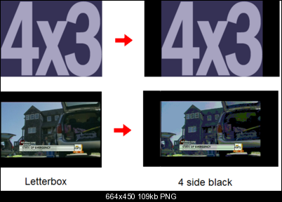

  8. I am seeing the side bars after recording a letterbox show. The show originally goes all the way from one side to the other of the widescreen with of course the letterbox bars above and below. The recording ends up in a 4:3 shape so the orginial letterbox show ends up pillarboxed in a 4:3 center. Was trying to see how to avoid having the letterboxed show end up 4:3 and therefore postage stamped.
    I did some graphics to illustrate this in a prior post. I'll try to find these this evening. Your TV is creating the side pillars.

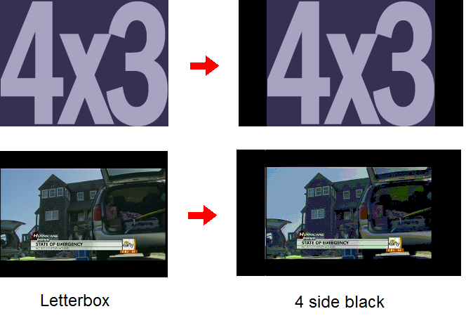

    Found it. The left side shows what the cable company sends as 4:3 and letterbox. The right side shows how an HDTV normally displays them.
    If you want to process the letterbox for 16:9 display, you need to deinterlace or inverse telecine, then crop off the letterbox and expand the remaining 704x ~396 up to one of the below, then encode.
    640x360 (square pixel)
    848x480 (square pixel)
    720x480 with wide flag (DVD compatible).
