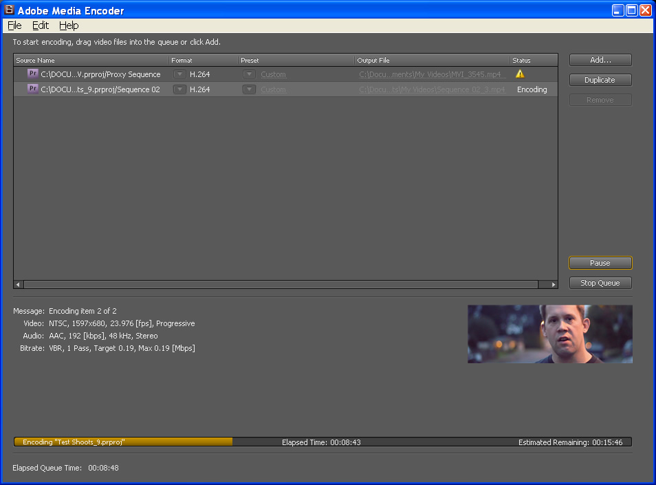

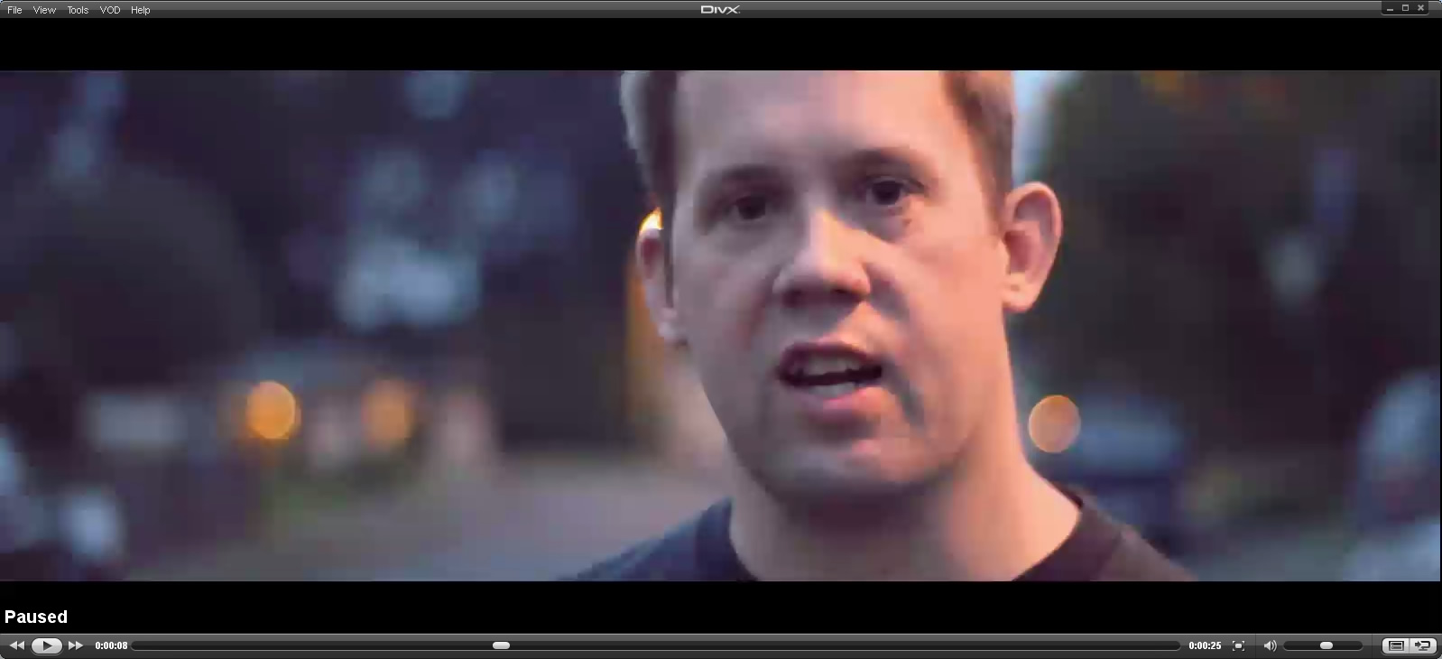

    Changing the PAR to Square Pixels helped correct the aspect ration. However, the clarity was significantly reduced and there is still a small black bar on the top and bottom of the export (see attached).
    Also (from the other attached AME image), you can see that the export preview looks just how I want it to look. I wonder why it would preview correctly but not render correctly...

  8. The letterboxing is likely added by your media player. Your monitor is probably 16:9 or 16:10 display, but 1920x680 with square pixels is at ~2.82 AR i.e it's wider than your monitor
    The clarity is lower likely because your bitrate shows 0.19 in the screnshot . Use a higher average bitrate, and an even higher max bitrate
    It also looks like you entered the wrong dimensions: 1597x680
    Instead of rendering out the entire project for these tests, mark in /out a few seconds to test - this way you waste less time
    Are you going for a 2.35:1 AR export (e.g. like many Hollywood movies use) ? Because 1920x680 is the wrong format it's ~2.82AR

    Yeah, I noticed the error in dimensions after I posted my last comment. I'm re-rendering now but will change the bitrate (I was so focused on getting the frame dimension correct, I didn't even bother looking at the bitrate) and re-render again.
