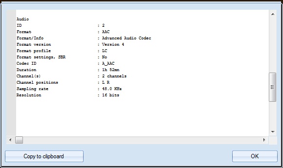

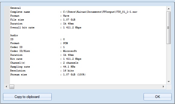

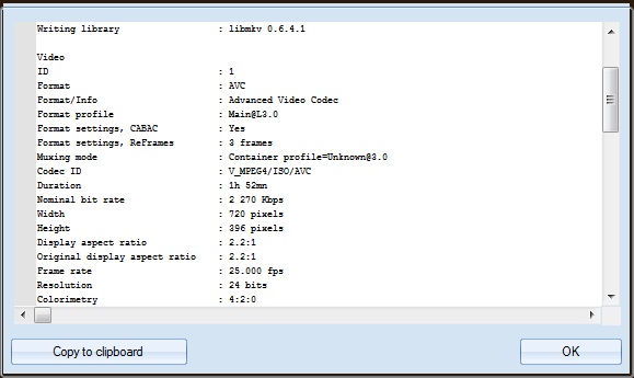

  18. How i Adjust PAL audio in NTSC Video
    A) DVD Movie (Run Time - 2H 18M 45S With Director cut)
    8 Gb
    NTSC
    29.976 fps
    Audio in English
    B) VCD of Same Movie (Run Time 2H 04M 54S Theatrical cut)
    3 Disc
    PAL
    25 fps
    Audio in Hindi
    1) Aimersoft Video Converter – I convert 3 VCD in one MKV file with 29.976 fps
    2) Format Factory – that MKV file audio convert in Mp3
    3) Power Ac3 Converter – that Mp3 audio convert in Ac3 for use of Delaycut
    4) Delaycut – that Ac3 audio i adjust that how i want (like 5 cuts some time +562 ms or some time -1050ms)
    5) MKVmergeGUI – 8 Gb DVD Vob convert in MKVth help of MKVmergeGUI,
    then in that MKV file add my Ac3 (Hindi) audio & adjust video in 25 fps
    and Now my movie will play with English & Hindi audio.
    But I can’t understand that my audio Ac3 Hindi is 29.976 fps & when i make
    MKV with help of MKVmergeGUI video 25 fps is match?
    But end of the day I got what i wanted!
    (I was posted in forum yesterday i post pic of what really i do but some how I can’t do that ,sorry)
    "The Strongest people aren't always the people who win,but the people who don't give up when they lose"
