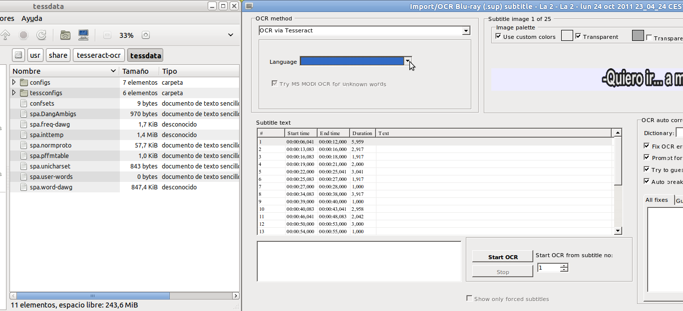

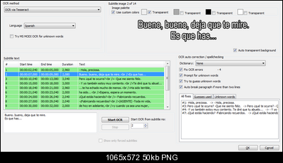

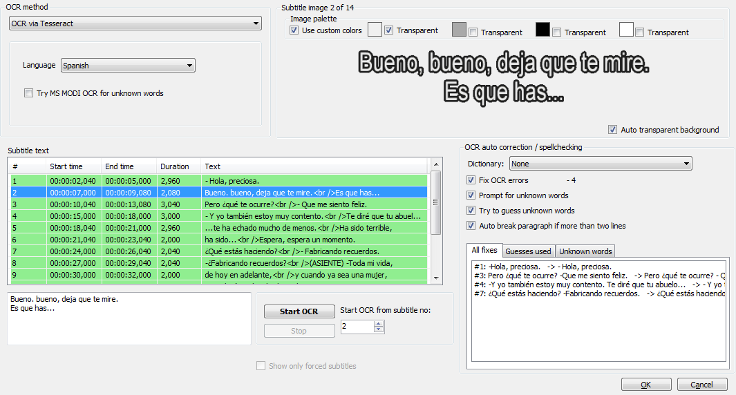

    Jul 2011
    Denmark
    Hi edea!
    Thx for testing
    I could not open the SON file with SE 3.2 at all...
    In order to use Tesseract you need to use "Spanish" tesseract dictionary for Spanish subtitles (and English for English subs).
    I've fixed the SON file reading + included Spanish dictionaries in this version: http://www.nikse.dk/SubtitleEdit.zip
    You could also use "Image compare" as ocr method (a bit like subrip)

    I'm testing you great SE program thanks to edea suggestion.
    I'm running SE v3.2.2, build 25663 in XP SP3, .NET 2.0 and all work fine for me.
    My old workflow was use suprip/subrip and after OpenOffice to spell check, now I can make the two task togheter thanks to SE.
    And the job is more easy thanks to new word/names stored in static files.
    But the best improve is the rules in eng_OCRFixReplaceList.xml, I'm making mi own spa_OCRFixReplaceList.xml.
    I have a question.

    Seems the language is recognized and with spanish subs the spa_OCRFixReplaceList.xml is used. OK.
    BTW, most of my problems with 'l' -> 'I' was solved changing the
    <WordPart from="l" to="i" />
    with
    <WordPart from="l" to="I" />
    if the change is inside (not at begining) a lowcase word a second pass solve the problem.
    What is the difference between <PartialWordsAlways> and <PartialWords>?

    No, I can't select ANY language...

    Jul 2011
    Denmark
    Hi edea!
    I think you have tesseract 2.x... SE needs 3.x !
