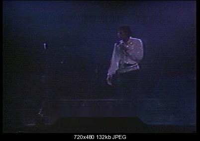

    After removing a logo, the processed part looks blurry and too smooth compared to the rest of the video.
    I would like to capture the noise/grain on a regular part of the video and replicate it to the part where my logo has been removed. Is that possible?
    Thank you in advance for any advice

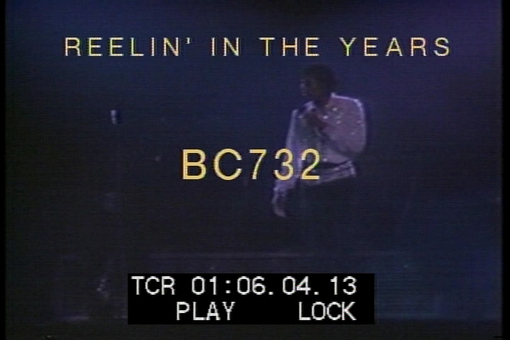

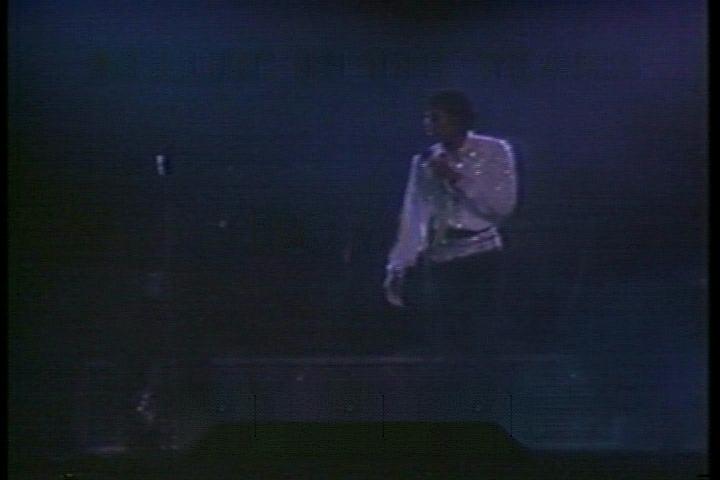

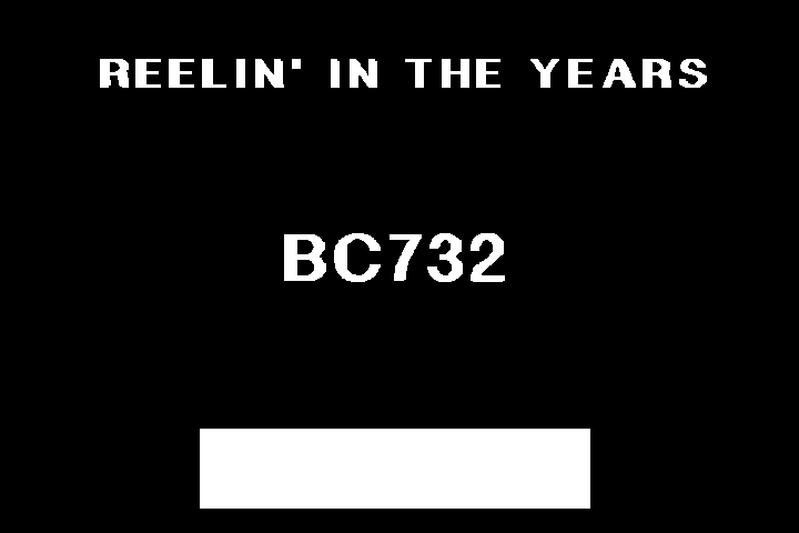

    I think the mask you made is 90% of the problem. It's not even close. Why don't you refine that mask instead of fixing the result of it? The overlap is getting interpolated to grey.
    Confucius Say: If you have to add noise to a video to make it look better, something smells in Denmark.

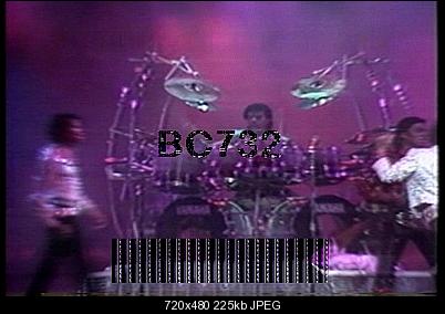

  16. Thank you all for your answers and explanations
    I followed your advice Gavino.. don't know if I applied it correctly though
    here is the code I wrote:
    source = directshowsource("DVD6-Title1.mpeg").Trim(10020, 10120).crop(0,80, -0, 120).ConvertToYV12()
    super = source.MSuper(pel=2, sharp=1)
    backward_vec2 = MAnalyse(super, isb = true, delta = 2, overlap=8,blksize=16)
    backward_vec1 = MAnalyse(super, isb = true, delta = 1, overlap=8,blksize=16)
    forward_vec1 = MAnalyse(super, isb = false, delta = 1, overlap=8,blksize=16)
    forward_vec2 = MAnalyse(super, isb = false, delta = 2, overlap=8,blksize=16)
    smooth = source.MDegrain2(super, backward_vec1,forward_vec1,backward_vec2,forward_vec2,thSAD=5000)
    noise = mt_makediff(source, smooth)
    stackvertical(noise, noise, noise, noise)
    clip = avisource("delogo_1.avi").ConvertToYV12()
    mymask = imagesource("logo3.1.bmp")
    Overlay(clip, mt_adddiff(clip, noise), mask= mymask)
    and here is the result:

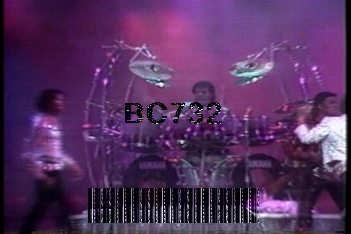

  19. A quick attempt with Overlay(mode="hardlight") (thanks to intracube):
    src=ImageSource("org.jpeg")
    mask=ImageSource("mask.jpg").Blur(1.0).Blur(1.0)
    cln=ImageSource("cln.jpeg")
    noise=Subtract(src,Blur(src,1.0).Blur(1.0).Blur(1. 0).Blur(1.0)).Crop(128,200,128,128)
    noise=StackHorizontal(noise,noise,noise,noise,nois e,noise)
    noise=StackVertical(noise,noise,noise,noise)
    Noise=Crop(noise,0,0,720,480).RgbAdjust(rb=4,gb=4, bb=4)
    Overlay(cln,noise,0,0,mask,mode="hardlight")
    This would work better if you have a section of all black frames from which to build a noise video. Overlay is causing an overall color shift.

    I don't know about Photoshop/GIMP, but in Avisynth, Overlay(mode="HardLight") uses the formula
    out = base + (overlay-128)*2
    The factor of 2 (and the use of 128 rather than 126) means it can't be used in conjunction with Subtract without some other adjustments.
    That formula does exactly what Blender's 'linear light' does. 'Hard light' in GIMP produces quite a different effect. I'm not clued up on the exact differences between them - need to do some research, but GIMP's hard light was what I was suggesting. Blender doesn't seem to have hard light at all.
    Good point on the 16-235 vs 0-255 midpoint issue. I usually work in 0-255 land for colour correction.
    The problem is Subtract(). If it simply subtracted one image from the other some of the results would be negative. Since you can't represent any values below zero with unsigned 8 bit integers all the negative values would be lost (become zero).
    Blender's node compositor can deal with values outside the 0-255 range. It's a nice feature, but can also cause confusion for people like me who like to do things by eye. Adding two images together when one image has blacker than black negative values will of course subtract/darken parts of the image.
    "Internally, the Compositor uses float buffers only (4 x 32 bits)" link
  27. Originally Posted by Gavino View Post
    Ah, the *2 explains why I was getting more noise than expected. Easily corrected.
