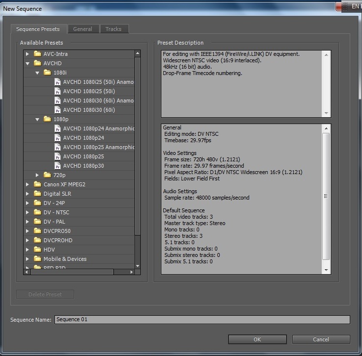

    Hi edDV and all,
    Please find attached two screen captures of PP "project settings", here I have to choose the settings that match my source material. Please, which would be the proper choices to
    1) edit movies made with my Canon AVCHD camera ?
    2) ATSC broadcasts (.TS files) ?
    I believe that, for my home movies, I must choose AVCHD -> 1080i -> 60i Anamorphic, please am I right ?
    For TS files, I may choose HDV 1080i30 (60i), am I right ?

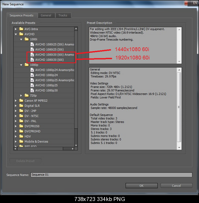

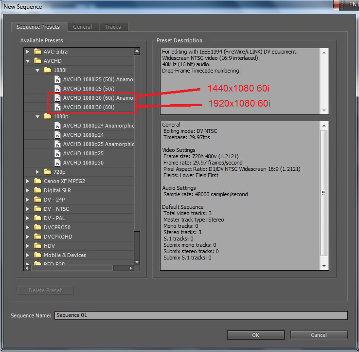

    For AVCHD it depends on which mode you used in your camcorder.
