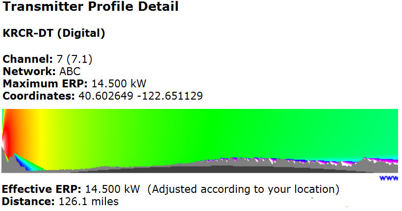

    PS: I just tested reception and am pulling intermittent UHF stations out to 90 miles but note that I'm at ~3000ft elevation and these transmitters are at 1,000-2500ft elevation hence earth curvature and ground weather effects aren't an issue. I'm using a Wineguard HD7697+CM7777 Pre-amp. I'm locking in VHF CH7 at 126 miles (2 Edge) most of the day. "2 Edge" means two mountain ridges in the path.
    [Attachment 9146 - Click to enlarge]

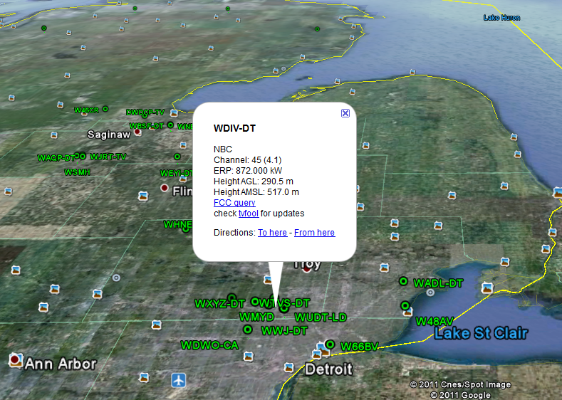

  9. Member edDV's Avatar
    Mar 2004
    Northern California, USA

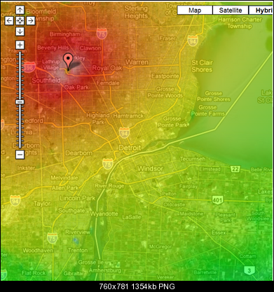

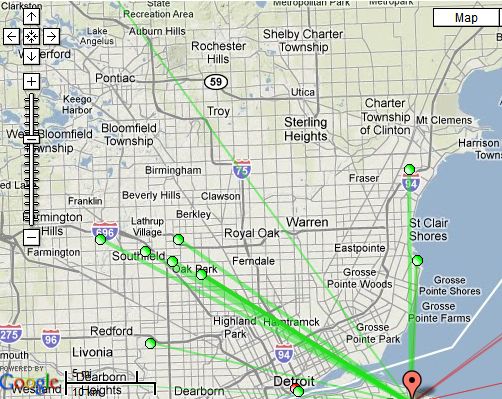

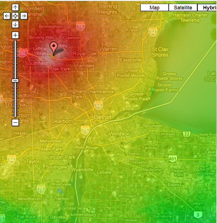

    You may not know about this tool. You can add the TVfool database to Google Earth (separate overlays for digital TV, analog TV, AM radio and FM radio). Then you can tip back into 3D terrain mode and observe obstacles. This doesn't work as well with flat Detroit.

  10. Member edDV's Avatar
    Mar 2004
    Also a signal strength plot for each transmitter. This is WDIV-DT (NBC).

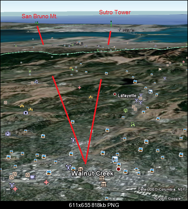

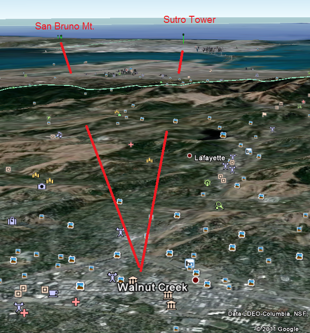

    As an example, Google Earth can show the hills blocking access to the towers. Walnut Creek, CA is a notoriously poor reception area.
