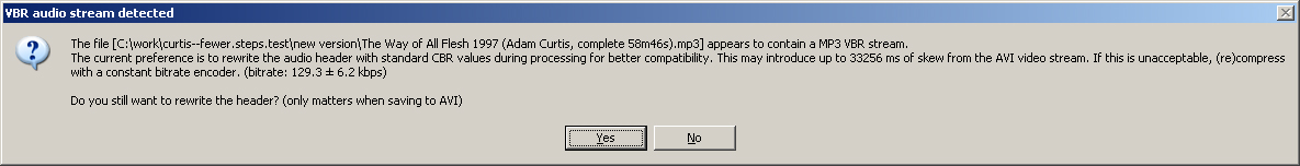

    One (I think last) question. When I remuxed the edited audio, VirtualDubMod 1.5.10.2 gave me a warning because it thought it ("appears to contain a MP3 VBR stream") VBR.
    I think because while the audio for both sections (which I joined) was CBR (MPEG-1 Layer 3 48000 Hz Joint Stereo), one file's audio was 128kbps and the other file's audio was 160 kbps.
    Avidemux didn't mind when I did the join. And the joined file plays perfectly on all my players and boxes. But I wonder, will the .avi have less compatability since I didn't recode one file's audio bitrate to match the other?
    You can click to view, or read here, the rest of the VirtualDubMod message: "The current preference is to rewrite the audio header with standard CBR values during processing for better compatibility. This may introduce up to 33256 ms of skew from the AVI video stream. If this is unacceptable, (re)compress with a constant bitrate encoder. (bitrate 129.3 +-6.2kbps) Do you still want to rewrite the header? (only matters when saving to AVI)?" Then I clicked "No" and saved the .avi

    Your new file is VBR by construction.
    MP3DirectCut makes correct MP3 files, so that should be fine.
    I think you will get that message with any VBR MP3, as the old version of VDub isn't really happy with it. But it should work regardless. Don't let it rewrite the header.
    If it doesn't play in sync, try to mux the new audio in with Avidemux.

    Thank you AlanHK. The audio synch is perfect.
    I guess since you didn't say otherwise, I shouldn't worry that the .avi will have compatibility issues on some playback devices because I didn't recode one file's audio bitrate to match the other before joining.
