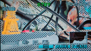

    Most camcorders have issues with "auto white balance" but there has been great improvement since Video8. The HV40 also has manual white balance that works very well. Like most consumer cameras, peak white can extend into 236-255 but clipping is detected and displayed as a Zebra pattern in the LCD monitor just like a pro camcorder.
    Zebra pattern showing clipping
