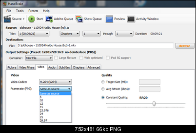

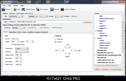

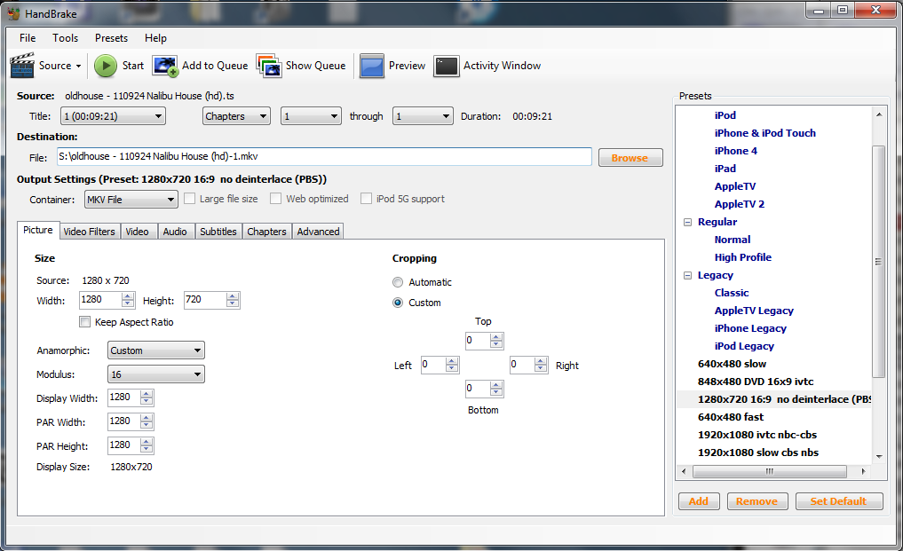

    If for some other reason you wanted a 1280x720 downscale, here are the settings I use as my abc/espn/fox/pbs Handbrake preset.

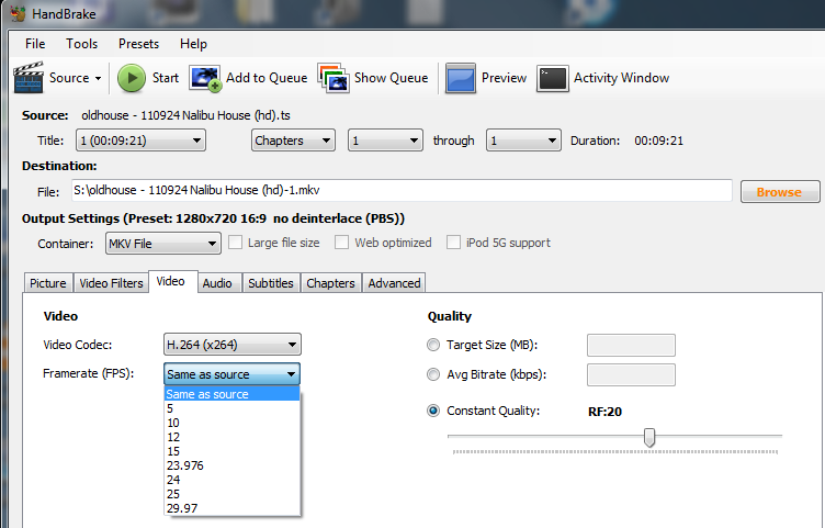

    Frame rate and encode quality settings are under the Video tab. Constant quality default is 20. For better quality lower this number. For smaller files increase the number.
    [Attachment 9066 - Click to enlarge]
    [Attachment 9067 - Click to enlarge]

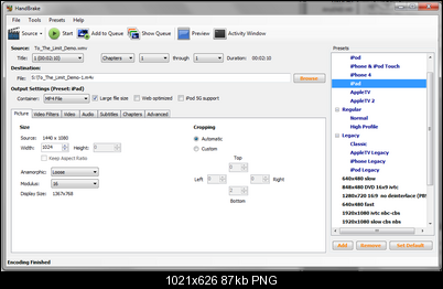

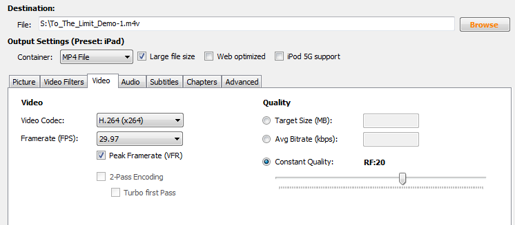

    I ran this file through Handbrake with the iPad preset and got a this which plays in VLC, MPCHC, WMP and Quicktime players. I don't have an iPad to test.

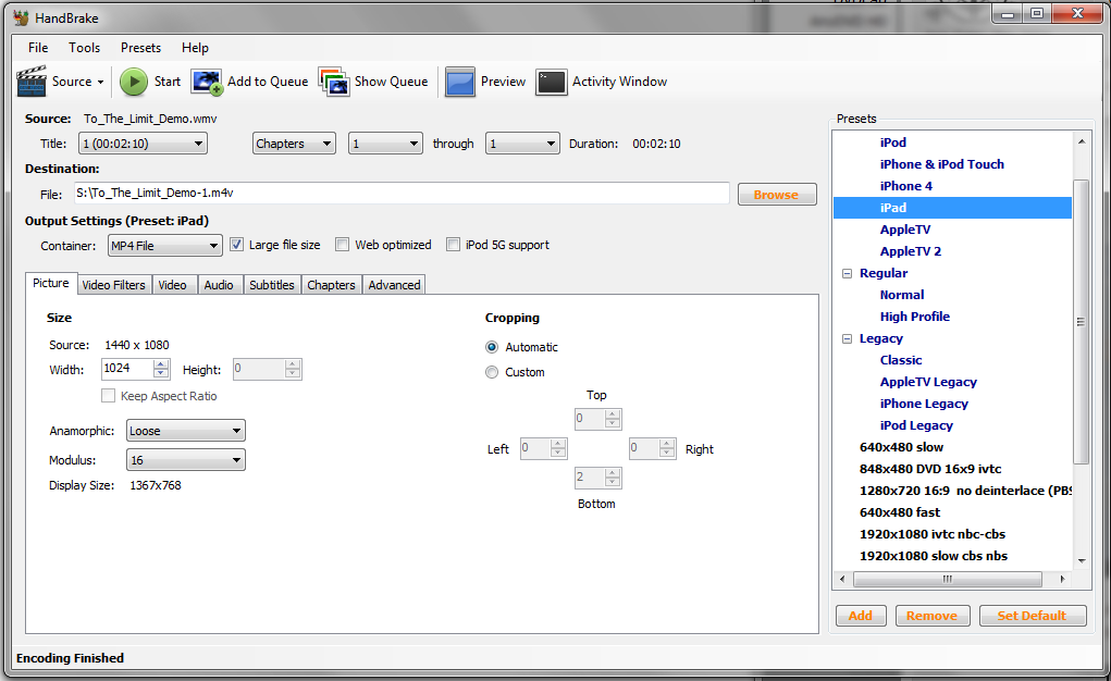

    When I imported the 1080p WMV source file into Handbrake and selected the iPad preset, these were the resulting settings.
    PS: The resulting file also plays in my Sony BX-37 (S370) Blu-Ray player which upscales it to 1080p. The original WMV-HD (VC-1/WMA) file also plays in native 1080p but without audio.

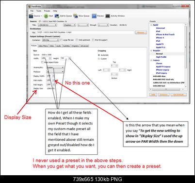

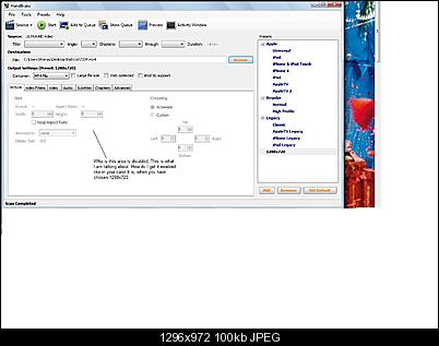

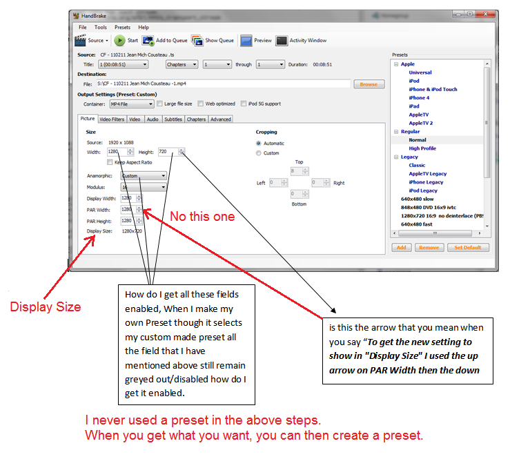

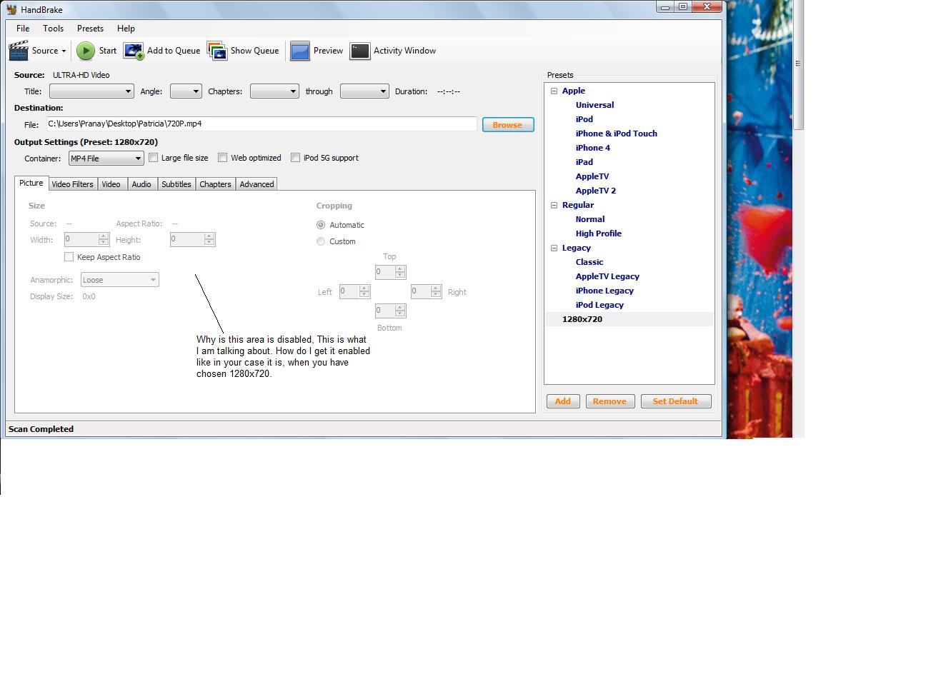

  8. I am using Handbrake Ver 0.9.5 and when I select a preset in it, all the fields in the picture Tab get greyed out just incase if I wanna manipulate it or use my own settings how do I get those fields enabled ?
    I know how to add my own preset but I am looking out for how to manipulate the fields in the Picture Tab ?
    My version is 0.9.5 as well.
    I did the whole WMV-HD to iPad thing above and it seemed to work. Beyond that I don't know what you are trying to do. You haven't provided the mediainfo data from your source file.
    In general when you open a file, Handbrake presents an automated estimate then you modify that.
    Consult the user manual
    https://trac.handbrake.fr/wiki/HandBrakeGuide

  10. Originally Posted by edDV View Post
    I am a little Novice in all these Can you please guide me and give ma a tutorial on how u did that. If I may pls request more help here...I absolutely have no idea besides just selecting the source file selecting the destination folder and click start Yeah seriously !!

  12. Originally Posted by edDV View Post
    How I did what? I included the Handbrake setup screens for the iPad conversion above.
    If I wanna convert it to 1280 x720 there is no preset available for that. I was talking about the first 2 screenshots that you have put not the one in which you have selected iPad as your preset, the one before that.

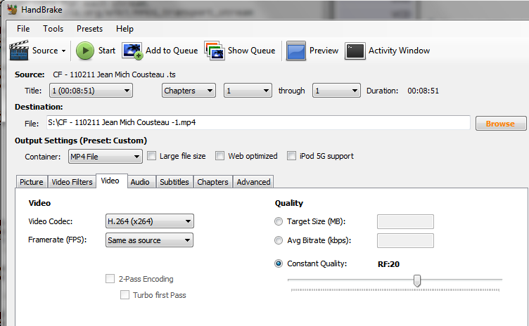

  13. Member edDV's Avatar
    Mar 2004
    Northern California, USA

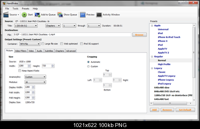

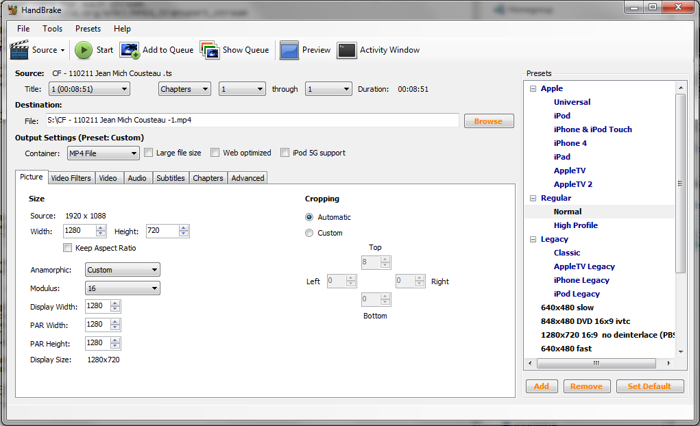

    1. I imported a 1920x1080 60i TS source file (from CBS)
    2. I typed in 1280 width and 720 Height.
    3. To get the new setting to show in "Display Size" I used the up arrow on PAR Width then the down arrow.
    4. Since this file is interlace, I selected the Deinterlace Slow filter. (skip this step for 1080p)

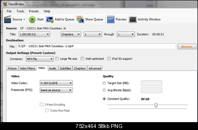

    5. Under Video tab, I made no changes. But you can play with CQ, bit rate or target size.
    Resulting file spec (from Mediainfo)

  15. @edDV
    Thanks Mate you are being of great help here. Please Check out the attached word doc.
  16. Originally Posted by edDV View Post
    BTW: 1280x720 is not optimal for the iPad but it should play.
    So What is the Optimum for iPad 1024 X 768 ?

  18. Member edDV's Avatar
    Mar 2004
    @edDV
    Let's try this...

  19. It still is a problem
  20. Member edDV's Avatar
    Mar 2004
    I'm not sure. I'll look at it this evening.
    Delete your 1280x720 preset and don't use presets for now.
    Close Handbrake then open and re-import the file. The settings should be available.
    http://www.kiva.org/about
  21. Originally Posted by edDV View Post
    Oh Yeah I know that, there is no problem with the inbuilt presets but when I create my own preset I want the felds in the picture tab to be enabled that is what I am saying. How do I do that ?
  22. Member edDV's Avatar
    Mar 2004
    If you don't use presets, you can modify at will. Maybe you need to reinstall.
  23. No Buddy, Still Can't get those fields enabled whether I select a Preset or not, irrespective of that it remains disabled !! Can u show me how do get those fields in the picture tab enabled ?
  24. Member edDV's Avatar
    Mar 2004
    Uninstall-Reinstall the software. You broke it.
  25. Originally Posted by edDV View Post
    Yo Man ! I unisntall and Reinstalled now the Fields in the Picture Tab do get enabled
