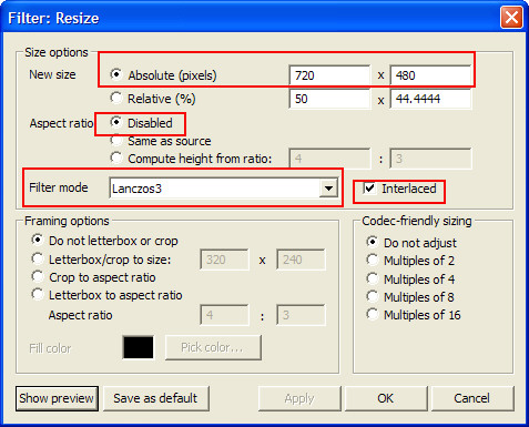

  4. First, the vdub interlaced downscale isn't the greatest because it simply separates fields then resizes them using whatever algorithm you choose e.g. Lanczos. What you should be doing is smart bobbing the footage, resizing, then re-interlacing as jagabo described in the other thread. The vdub workflow is certainly better than Adobe's interlaced scaling , but still... (also CS5 with MRQ and CUDA might produce "acceptable" results for some people now)
    If you've exported a 1440x1080 60i lagarith AVI from AME, it's important that it's NOT the YV12 variant (because vdub doesn't handle interlaced YV12 correctly, it upsamples as progressive and you will get chroma artifacts) . If you've used filters like color correction in your edits, I would export lagarith in RGB mode (checkmark always suggest RGB box)
    In the resize dialog, check disable aspect ratio first, then enter 720x480, select lanczos3 from the drop down box, then checkmark interlaced. Push preview to see if it looks ok, then apply and ok
    Exporting lagarith in RGB mode after applying the vdub resize should work in premiere, but be aware there are other MPEG2 encoders that some people may prefer over the mainconcept based MPEG2 encoder bundled with Premiere eg. HCEnc
    If you're putting this back into premiere, you usually have to interpret the aspect ratio (most intermediates are "seen" by premiere as square pixel 1:1 PAR, but NTSC 720x480 doesn't use square pixels, so right click the re-imported clip and interpret the proper 16:9 aspect ratio)
    If you use avisynth you can skip a few steps and don't need some of these intermediate files or stages . That's what it does - frameserve. You can also do a better resize using scripts

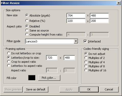

    I rather like the Virtualdub resizing algorithm for 1080i > 480i and have made it my standard tool for this job. I allays shoot and edit in full HD and output to Blu-Ray, however some people still use need SD dvd versions. I use Vegas to edit and I frameserve the timeline into Virtualdub, apply the resize filter and then frameserve into TMPGEnc. The quality is very exceptable and no aliasing issues with the HD > SD resize that is prevalent in many other methods.
    I do as PoisonDeathRay suggested, only I resize to 704 x 480 and letter box out to 720 x 480:

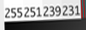

  7. I covered this in the OP's other thread but I'll repeat it here. VirtualDub's method is one of the crudest. That VirtualDub resize is the equivalent of
    SeparateFields()
    LanczosResize(704,240)
    Weave()
    AddBorders(8,0,8,0)
    in AviSynth. That will lead to ringing and blurring on sharp edges. Fortunately, most camcorder video isn't so sharp so it's not too visible.
    1080p source:
    480p result (upscaled 3x, nearest neighbor):
    Notice the white halos and the black line beneath the border between the white and gray. Actually, most of that is due to oversharpening by Lanczos3. You can alleviate most of it by using Precise Bilinear instead. Of course, that will result in a less sharp picture.
    A better method is to use a good smart bobber, resize, then reinterlace. Unfortunately, that can be very slow.
    It's not really necessary to resize to 704 then pad to 720. One can resize to 720 directly. The DVD spec refers to the MPEG 2 spec regarding aspect ratio. The MPEG 2 spec clearly states that the full frame comprises the flagged aspect ratio. Of course that's at odds with with the BT/ITU spec for digitizing analog video. You could avoid the conflicting specs and resize to 704x480 and leave it there. 704x480 is compliant with the DVD spec.
