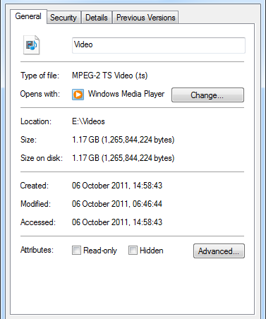

    Hi
    How can I import MPEG2-TS video file video (.ts) extension to Adobe Premier Pro CS4/5?
    I've research almost everywhere but not succeed to find my answer, so though might worth posting my question on this forum as well, hopefully somebody could help!
    The video details which I'm trying to import to Adobe Premier Pro and also converting to MKV:
    By the way anyone having any experience on converting MPEG2-TS video files to (.MKV [H264])? The reason asking is because even when I try to convert my video files to MKV I get no sounds... any idea why?

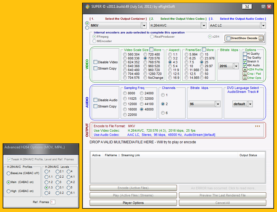

    Here is my current settings:
    Windows 7 64-bit, Intel Core i7 950 @ 3.07GHz, 4GB RAM, ATI Radeon HD 5700 Series, 1TB HDD
  13. Looks like it doesn't have deinterlace. Try the "o" other options button. Or maybe try another program

  16. maybe mediacoder? super is just a gui for ffmpeg and mediacoder. You have it set on "ffmpeg" in the screenshot
    The other option is to encode same dimensions, and use aspect ratio flag either in encoder or container (mkvtoolnix)
