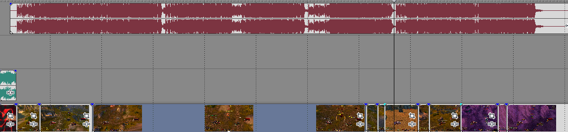

  3. Yes sir.

    Everything looks normal. You better check your render settings again.
    Select a short sample and render to a stock template as a test. Using custom templates is fine, but some audio and video don't go together.
    Since you were able to render audio previously, you may want to delete your custom template and make a new one.
