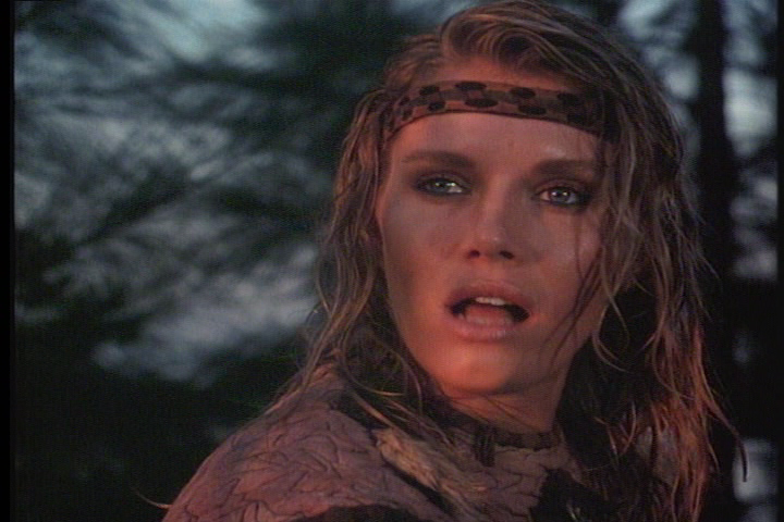

    I'm currently working on encoding oneof my old DVDs to MKV its quite awful (looks like it was poorly encoded vhs rip), i need a few suggestions best approach to clen this up I've attached still image and video info and my last attempt at a avisynth script.

Name:	Barbarian Queen.VOB.png

  9. Oh, I take it back. You have the 1.33:1 version. At first glance I thought I noticed you had the widescreen 4:3 version.
    The main thing wrong with it I can see is that the blacks are horribly crushed.
    As for whether or not the 16:9 version is better, I don't really see how it can be any worse. In addition, it was (apparently) shown in theaters as 1.78:1, so it's supposed to have been cropped. It could very well be that the 1.33:1 version is a cropped (or panned and scanned) version of the 1.78:1 theatrical cut, meaning it's been cropped twice from the way it was originally shot. There's no way to know that for sure unless and until you have both versions to compare.
