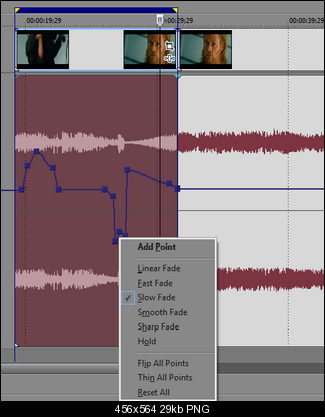

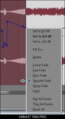

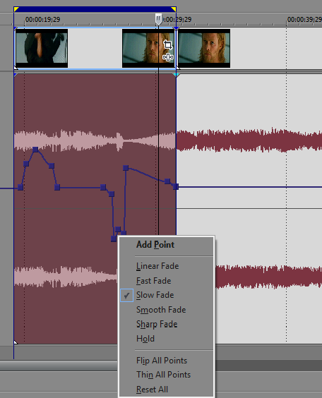

    You have lots of control if you widen the view and add volume points. You can do this on each track.

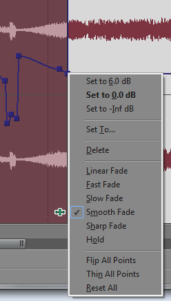

    Point Properties
